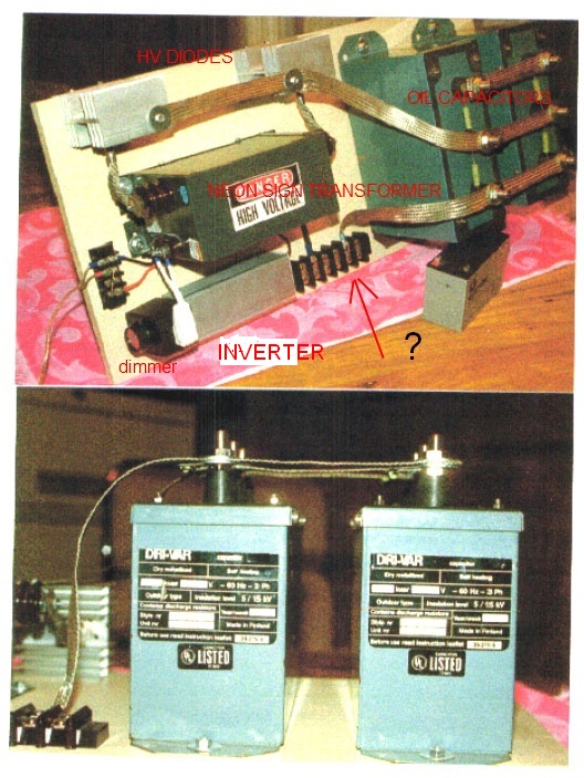

      I'm new here on this forum and very interested in Don devices especially the device on the attached picture.
      I'm curious if someone can elaborate how this type of device may operate without a sparkgap.
      On this picture an isolation transformer is not shown.
      Sparkgap has all frequencies in a bandwidth range where the LC resonance could be. When there is no sparkgap the device should have one selected resonance frequency from the HV transformer to the capacitor and isolation transformer.
      Don mentions a iso-transformer connected to a capacitor. This capacitor is at resonance with the iso-transformer. Typical 50-60Hz. If we want high energy at the output of the iso-transformer he said that he used a very big one because of the mains frequency generation and large currents.
      The device operates in my opinion as a electron pump from the earth (negative) on a resonance LC circuit. When there's is load, the resonance frequency is changed so the load should be know first when it's is activated.

      Exactly my thoughts! Electron pump. I have also a few questions about picture you posted , maybe somebody can explain.
      Why those large capacitors have 3 terminals ? How they are connected then ? In series or parallel or somehow strange ?
      What is that strange device at bottom ? (I placed ? there)
      Can we draw schematic of this device ? I don't see spark gap here and anything like primary /secondary pair - EXCEPT neon sign transformer !

        • Originally posted by boguslaw View Post
          Sorry, I forgot picture.
          "?" is standard electrical connector, like in this picture.
          About 3 terminal cap:
          Unlike conventional two terminal capacitors which have high residual inductance within the lead wires, thereby impeding the path of high frequency noise to ground, a three terminal capacitor forms a T-filter providing high inductance in series with the line, via two integral ferrite beads, and low inductance to ground via the bypass capacitor. Thus they provide increased attenuation with frequency over conventional decoupling capacitors
          • boguslaw, I'm going to just take a guess here but based on some very old caps I've got I'll guess those big caps with 3 terminals are just a dual capacitor in one box. One terminal is the common and the other two are each an individual capacitor just housed in one box.
            • Originally posted by Zlatko View Post
              Ok,Thanks. Still there is connection to this connector which is going to NST probably and whcih is not clearly visible on picture but anyway this all looks like Don's circuit part around primary coil.That would mean we could just use big huge nst alone without spark gap, primary/secondary but only with diodes and output caps . Interesting.

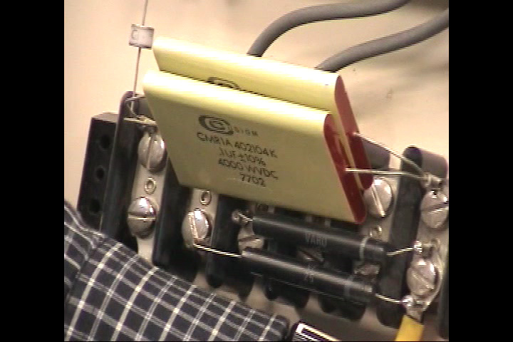

                Zoom in on left connector bar, looks like lightning arrestor across there too.
                    This is also the setup I'm gathering the parts for.
                    The 3 terminals on top of the large capacitors are normally used in 3 fase power systems, inside the case are a couple of mpp capacitors connected in parallel to get the high capacity. These caps are rated high and Don uses them in parallel so thats a high capacity. I'm thinking Don uses a very big isolation transformer behind this setup to get 60Hz resonance. I'm starting with 1KVA isolation transformer and dimmable old fashion iron cored 9KV neon transformer.
                    My 380V input side of the isolation transformer has 342mH. In theory it should resonate with 20.57uF so I'm starting with 2x40uF series with 3x2uF series in parallel to get 20.6666uF so that's very close. Will test this with freq generator first. Also getting a varistor to limit the volts on 370 in this tank.
                    • The device make no sense, there is no resonance.
                      It has no primary capaciter (and no secondary capacitor before rectifier), so the transformer is pulsed with
                      NST frequence and the big DC caps are charged at the same frequency.
                      If there is OU in this, then any high voltage transformer station by electric power company would happily bring it to your house
                      They use big wires too.
                      But if you build tis, please report your results.
