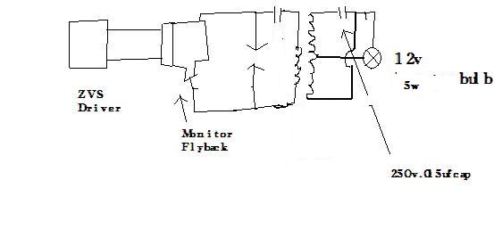

            • Bulb lights
              I managed to light a 5w bulb with my setup. The thing is when I tried to measure amperage input on my ZVS driver it was above 20amps
              My schematic is shown.
