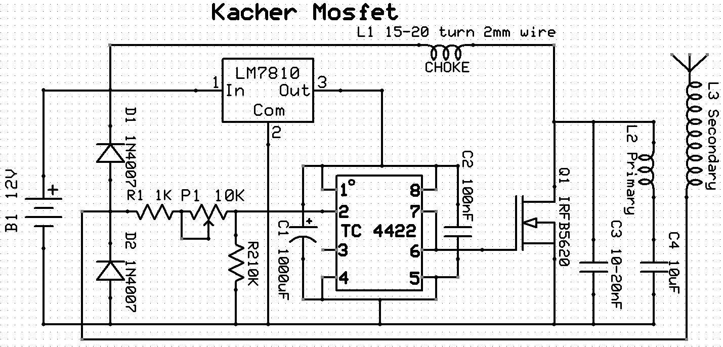

                  • nice and clean work
                    Originally posted by joefr View Post
                    Hi Zilano
                    Can you please help me with custom made high voltage NST which I made today per instructions in PJK book. I wound 4000 turns of 0.315mm diameter wire on 50mm diameter and 140mm length PVC tube. I then wound 8 turns primary with 1mm diameter stranded wire and 4 turns for feedback.
                    The problem is that I cant get higher frequency than 9.8Khz. If I put ferrite rods inside PVC tube the frequency drops to 3.5Khz. I have to use 27ohm resistor instead of 220 ohm resistor to get better output.
                    I put different capacitors parallel to 8 turn primary but frequency does not change.
                    Do you have any suggestion what to do, to get 35Khz HV frequency ?
                    Here is the picture of my setup, scope shot and circuit used:
                    JoeFR
                    I like your setup,
                    it may be your transformer, i have built that single transistor solid state circuit as well and it was running right around 28khz, one resistor for Duty cycle, and the other for freq, so the circuit should be fine, but the transformer idk.
                    i didnt stick with it cause i had trouble controling current draw, and i was looking for a finer square wave to drive the base of the npn
                    Heres the schematic i used, which i will do another vid of soon to show complete...
                    RMCybernetics - DIY Homemade Ignition Coil Driver
                    -Shunryu Suzuki

                      • Hi Mr.Clean
                        I already ordered solid state high voltage 12Volt powered power supply.
                        You can try this mosfet kacher circuit but you put signal generator on input instead of the bottom wire of tesla coil secondary
                        I tried it with my HV transformer and it was oscillating at 9.8Khz.
                        I then for test put signal generator on input and between 9.6 and 9.8Khz I get most output on secondary HV coil.
                        JoeFR

                            • Hi Boguslaw
                              can you measure inductance of primary ? I would like to compute how is that related to resonant frequency on primary side ? please also provide exact capacitance of capacitors connected to primary
                              In case of 2N3055 driver I did not use any capacitors parallel to primary because it not make any difference in coil frequency. I tried a lot of different but frequency did not change.
                              In case of mosfet driver driven with signal generator there are two 10nF capacitors in parallel to primary coil.
                              Here is the scope shot and picture of inductance of primary and secondary coil:
                              Scope HV Signal Generator Mosfet Kacher Circuit
                              Inductance Primary 8 turns 1.12mm diameter stranded wire
                              Inductance Secondary 4000turns 0.315mm diameter wire
                              JoeFR
