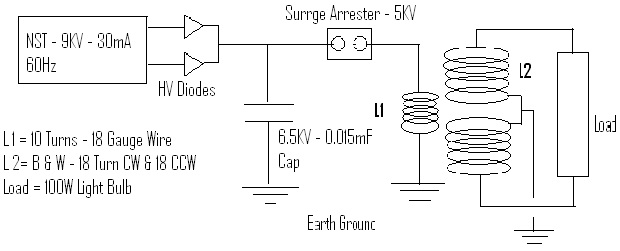

              • Hi Blue-Serge,
                the community will appreciate it very much if you could post a schematic of the exact connections. Further modifications will be easier to track and discuss.
                rgds John

                  • @JohnStone
                    Here is the circuit I used and demonstrated in the video.
                    @T-1000
                    Thanks for the suggestion. I'll work towards getting a ringing up wave pattern.
                    If you are asking what the input power and out power on my system, the system input is 240W and output I don't yet. I use for now a 100W bulb to see if there is work being done.
                    • zilano -
                      the circuit with MOV in it , what is a MOV ? and how do you get LV 350v ?? dc OR AC ?
                      • Originally posted by hello_all View Post
                        zilano -
                        Hi,
                        MOV (wikipedia) is a metal oxide varistor. This is a special kind of avery fast overvoltage protection (zehners are too lazy). In this schematic any overvoltage spike can fire the flash tube out of the inteded frequency by 2KV pulses. Therefore the MOV.
                        rgds John
