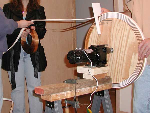

      Terry Blake's Huge Tesla Coil Primary
      Cheers Mike
