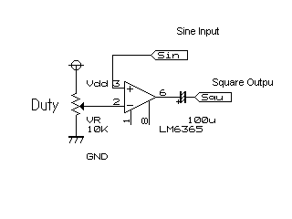

                    Sine wave to square wave
                    Anyone know how I can turn a sine wave into a square wave?
                    Still keeping it at 10 mhz?
                    • #55
                      Here is the schematic...
