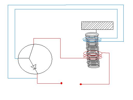

      Micheal,
      I was thinking for the last few days about on how to show this effect. I finally remember something similar to this I came accross more than a year ago when building my tesla coil. So if I don't apologize to you, I would have an ego problem, and we don't need anymore of those . Thanks witsend for your example on OU.com. I'm not worthy.
      I'm sorry for concluding the effect too soon rather than looking for other alternate experimenting methods.
      In my drawing from memory, the switching is done by the transistor. This eliminate the effect of unwanted magnetic field. The sourse of switching power comes from the secondary coil itself. Of this, I achieved about +/- 60mV DC. My electrical friend told me that is too little to do anything, I told him he has no taste for energy art. In short, the energy is always presented inside the coil, weather it is in resonance or not. Imagine if the coil is build to resonate with say sunlight frequency, then it is in resonance. The best switching method for this type would be a transistor. I know you have alot of ideas, we're ready to get rich for you.

        Yes this is the idea. But as I have often stated, you always have to put energy in to start the circuit. Now my idea is to use rechargable batteries and if and when the circuit is running the batteries get recharged at the same time. A touch of GRAY in this, that is the goal.
        Working on a circuit at the moment, prefer solid state, but a vibrating relay could be used, any ideas?

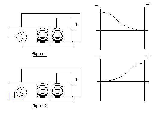

          I think what you're trying to accomplish is Aaron negative waveform circuit. I might I have an idea of how to achieve this without much tunning headache and technical build.
          I have found this effect during my experiment similar to the Anslie's circuit. The figures below are two different configurations I want to talk about. If one looks closely, figure 2 is different by switching the transistor feedback line. The first configuration heats up the transistor rather quickly. When I switch to the second configuration, the transistor running without heating up. Configuration 2 tends to shut off the circuit all together. I suspect the current canceling itself out so it destroy the oscillation. I would call figure 1 the auto resonance seeking and figure 2 auto anti-resonance seeking. The reason for this is also describe in the graph next to it. In figure 1, the switch is on when the potential differnent is as drawn causing current to flow through the battery. Figure 2, the switch is on when the potential different is as drawn causing current to flow back to the battery, thus canceling out if not recharge it. I observed this effect but at the time did not concern much about it.

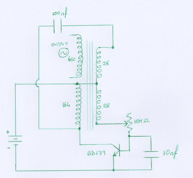

            This is my idea of the circuit
            This is what I am building at the moment and hope to test it later today, if I get time and if we do not get a power cut, we have a big storm at the moment been raining and thundering all night.

              BD139 tran: is giving problems
              having problems with the bd139 transistor, so looking for another

                I like the base to emitter capacitor set up for its own oscillation. I've first see the idea in the SEC, but never tried it. That means we can control the switching frequency? nice

                  The bd139 blew its tiny little top off and sent me smoke signals, tried a bc109 and it did work but the 10k pot is too big, need a 1k and I do not have one here apart that the bc109 will not stand up to the frequency, very iratic switching, need something strong, how about a mosfet? I have an IRFP054N, have to look up its data.
                  Did get the bc109 to oscillate but would not switch clean, gave me 19v on a pickup coil, from a 4.8v input from 4 nicads. Feed back to charge the nicads has to be capacitive if we are to get a self runner.

                        @Mike
                        Have you tried to connect the feedback coil to battery minus instead of plus, replacing the 10 nF with a diode, arrow points towards transistor base.
                        And finally add a pot between the base and battery plus.
                        Until you have it tuned and running OK, insert a resistor at battery plus, to limit the current within the transistor safe operating range.

                              Hi Eric, thanks for the input here. The point of the 10nf cap is to be able to choose a frequency to run at and to be able to tune the circuit with the pot.
                              I was able to get the circuit running with a 6v input and a 330v output AC and with a bridge rectifier 500v+.
                              I have now changed the circuit in the form of a polyphasing transformer using 4 coils so as to be able to increase the amperage on the output. First trials are encouraging, lower voltage but higher amps. When I have it how I want it, I will post the circuit.

                                Hi Mike
                                I would not put a cap at the base of the transistor (i.e.10nF), but stick to one timing capacitor only (i.e. the 100nF). If you want more than one timing element, they must match, so they don't "fight" each other.
                                In fact you have the "spatial" resonance of your transformer coils also, so there is something to consider.
                                The point of my suggested changes was to make it self oscillate, the two pots just adjust DC and AC bias of the transistor.
                                I look forward to see your circuit.
