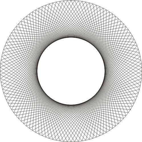

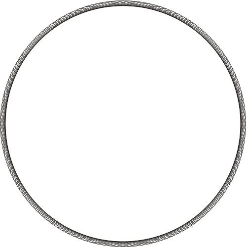

              Hi, first post here. The possible patterns for a 120 pin configuration are, starting from pin 0.
              1, 7, 11, 13, 17, 19, 23, 29, 31, 37, 41, 43, 47, 49, 53, 59, 61, 67, 71, 73, 77, 79, 83, 89, 91, 97, 101, 103, 107, 109, 113 and 119.
              Obviously the first and last patterns are of no use, since they are practically circles.
              It is interesting that all of them are prime numbers with exception of 49, 77, 91 and 119 which can be divided by 7 (7, 11, 13, 17).
              They mirror each other from 59 to 1 and from 61 to 119 being the only difference the start of the winding from pin 1 to the left in one case, to the right in the other.
              I will post drawings of the patterns if you want.
              • I just noticeed in that list of primes, that the difference between succeeding numbers is always a 2,4 or a 6....
                • 1, 7, 11, 13, 17, 19
                  Here are the drawings. Any thoughts?
                  • 23, 29, 31, 37, 41, 43
                    • 47, 49, 53, 59, overlapped
                      Please see full detail of the overlapping here Full Detail

                        Hi rococo,
                        thx for working out the possible steppings and posting the drawings.
                        I hope I can comment something meaningful after my magnets arrive.
                        How did you work out the list of possible stepping patterns?
                        BTW, as is visible in your drawings, the diameter of the center hole is different for each stepping. I found that too.
                        I think that a coil with a stepping pattern with big hole size will have a weaker field in the center.
                        So I put in the cardboard to make that hole smaller, so as to achieve a smaller center hole size, to boost/concentrate the field strength in a smaller "eye of the storm".
                        edit: changed the pic, as the earlier one contained a mistake in the winding pattern
