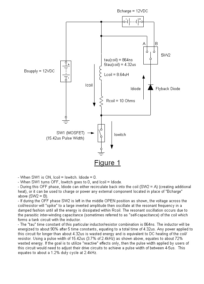

Before discussing anything directly about this subject, I would like to ask any individuals that have a "new age" slant on these topics, a question pertaining to "Capacitive Overunity Circuits".
To start, surely all would agree that inductors and capacitors are true opposites, or as one person says "mirror images of each other". Also, check out his circuit half way down the page....looks quite familiar. Odd he hasn't discovered any overunity in his testing
Here's the question:
If inductive circuits (particularly the inductive kickback type) are perceived and apparently metered to exhibit COP>1, then please illustrate an example of a complementary capacitive circuit that does the same.
