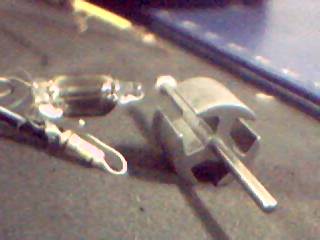

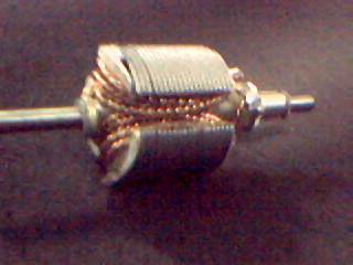

For a couple of days I have been rewounding small DC motor. My kids recently visit mini 4WD toy track with me. At first using just radiantly charged battery would give my kid big advantage, not many battery has overvoltage here. But then on second days, he meet the big boys with crazy modification on theirs.
My kid mini 4WD are standard current version of Auldey's with 23000rpm label. I can get the wheel and the side roller. For batteries I am confident with the radiant charger. But for motor, I would like to invetigate it my self of how to wound it better. I think this is a good way to put my knowledge from browsing around free energy site, if any.
Rewounding the motor with the above way help improve the motor tourqe. Maybe there is more to hand wound than what I know, But I guess this is atleast what I can do.

I also add 3 diode in the motor thinking that I can reduce the drag if I short circuiting coil collpase current. At least I don't notice slowdown after adding them, seems more tourqe now. Although I find it weird that the motor still can run on both polarity, I thought it would only run on one direction.
