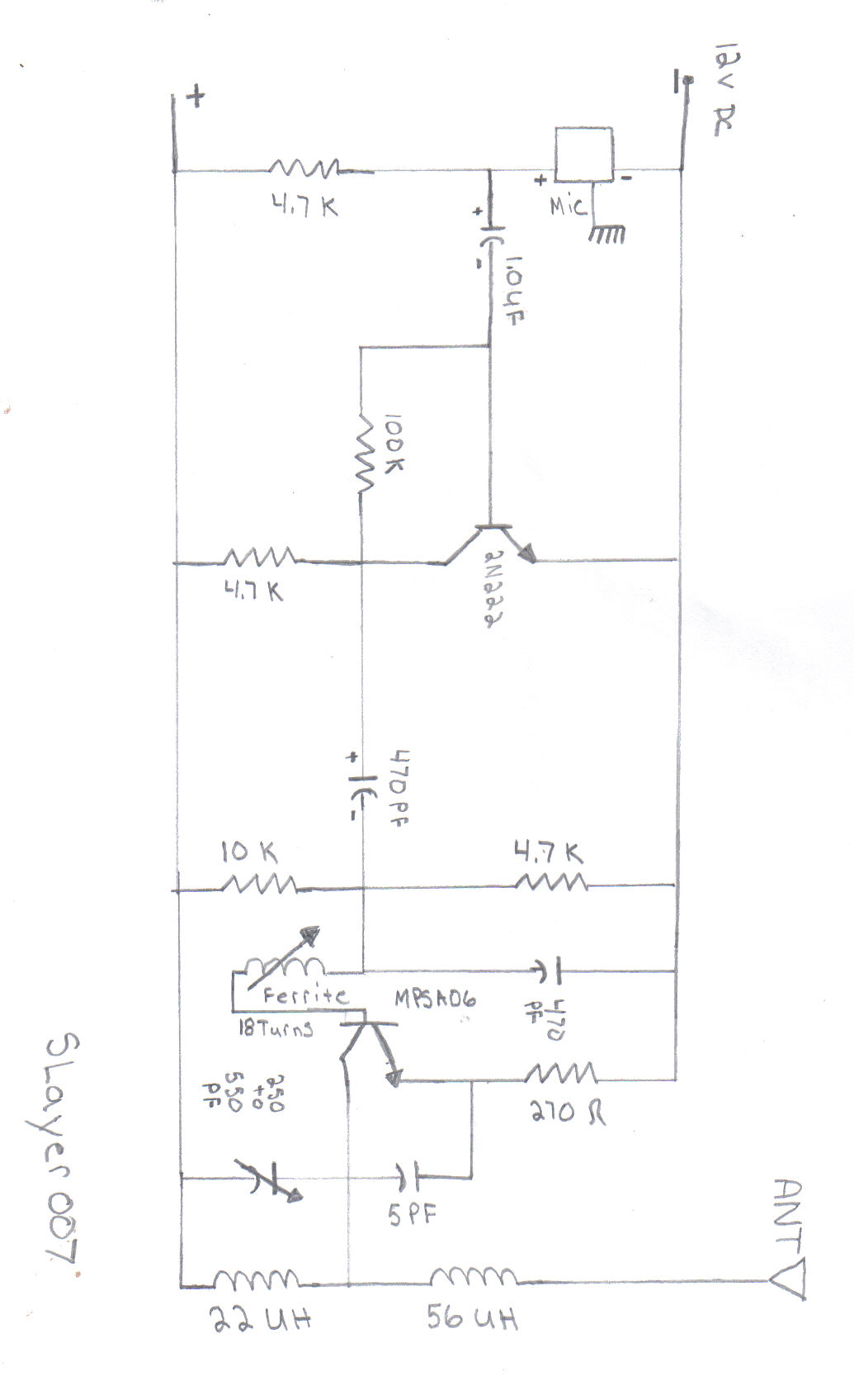

Here is a weak RF Transmitter circuit.
It can be made stronger by replacing the 270 ohm resister with a differant value.
Here is a video of it I made yesterday.
YouTube - RF Transmitter
In the video it wasn't working to great.It had a short in one of the wires and wasn't transmitting my voice to well.
But now it is working good and transmitting very well.
