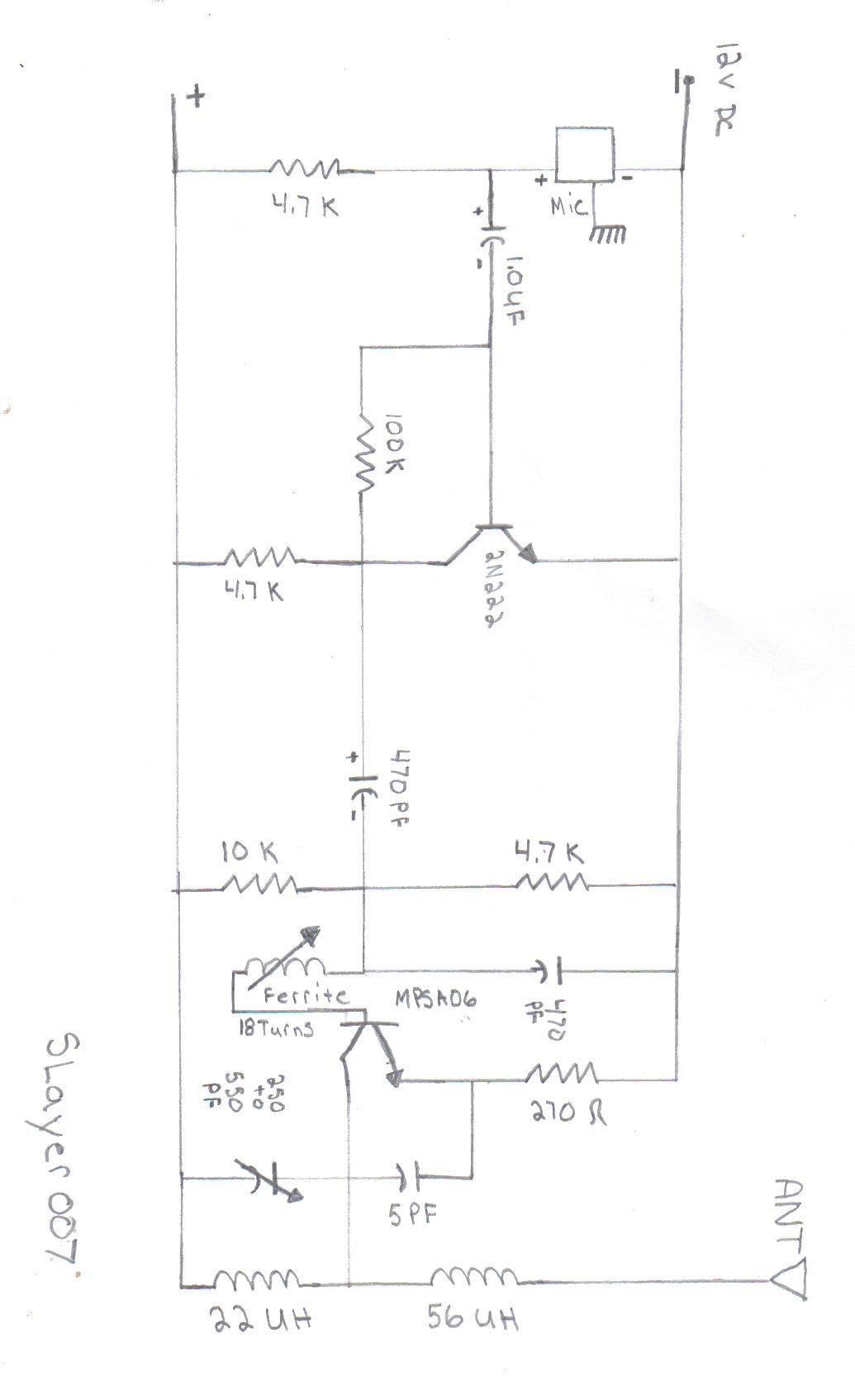

    Here is a weak RF Transmitter circuit.
    It can be made stronger by replacing the 270 ohm resister with a differant value.

    Aah I remember when I used to make a few of those as RF bugs
    A slight improvement on your schematic would be to put a tap on your coil. It allows you to amplify it a further step and isolates it so when you touch it, it doesn't lose stability.
