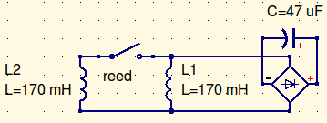

A magnet passing a coil with a rectifier charging a capacitor.
If You connect another coil, with a switch, in parallel with the first coil, possibly away from both the first coil and the passing magnet, You get a lot more charge.
See my video at YouTube - Charge from slow motion
Look at the minimal circuit below, L1 is the coil the magnet passes by.
