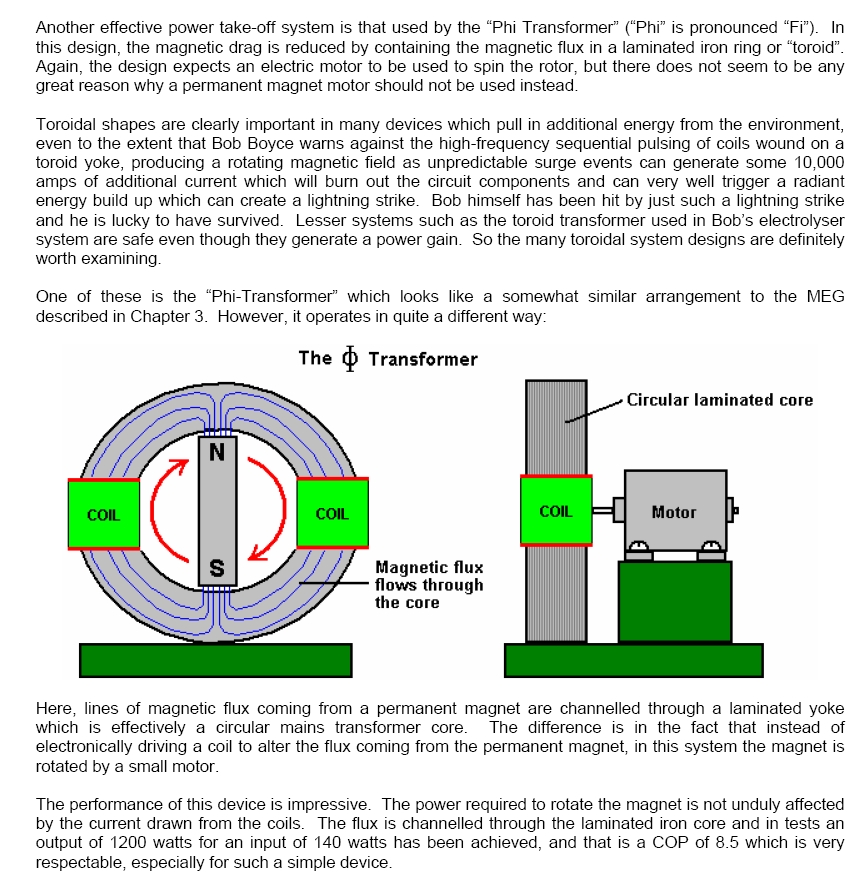

    I am going to build a phi transformer, like on this diagram I attached. I was wondering if anybody has tried this yet and if they got any good results.

    Been down that road already and I wouldn't get your hopes up. This configuration does not do what it says it does. Lenz law is in full force and the output is very low.
    I even tried a number of different configurations, none of which worked worth spit. This is one of those designs that only works well on paper.

          Magnetic induction in a generator is a particular thing. In order to efficiently produce current, the cores have to be short. Look at how a car alternator is constructed for a good lesson in core and coil design.
          When the magnet passes all that core material in the phi design, it realigns a lot of magnetic domains. This takes work which is unrecoverable (hysteresis losses). There is no getting around this loss. It's not a matter of the current going two ways and canceling out, because it's a local, physical effect.
          There are also eddy currents induced into the core material which add to the drag. If this were not enough, you further have significant magnetic field strength losses due to the length of the core.
          In short, it don't work so well.

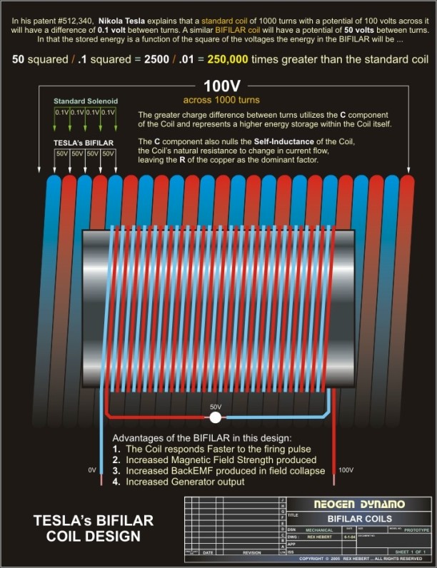

                    I have a torriod core that is about 2 inches in diameter. I have stated winding the wire for one section there will be two sections that go 1/4 way around the core. I am winding them like telsas bifilar coil. wind the coil down one side and then carry the wire back to the start and lay down the next layer . thay way the cails are all going in the same direction instead of back and forth like most coils.
                    Study the attched diagram. notice how if you follow the blue wire from left to right it then attches to the red wire goes back to the left side and lays down another winding. This is different than the bifilar coils everybody is used to winding. I am doing this and then reapeating the process for 4 layers.
