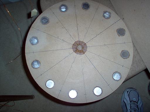

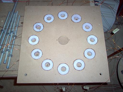

    Hi folks, been working on this dual rotor air-core motor and it is finished. Very interesting results so far, compared to the previous dual rotor air-core motor i had built that used four rotors with 6 neo's per rotor and 2 stator plates with 6 coils each for 12 coils total. This new 12 stator single plate, 12 magnet per rotor motor is performing better than the previous stated motor and with half the current draw at the same voltage. So it appears due to the pulse width on-time being less due to the larger rotors this makes the motor more efficient even though the duty cycle is the same, very interesting. I believe Troy reed invented a motor that took advantage of that fact and Joseph Newman does the same with his commutators, many pulses at shorter pulse width's to achieve equal or greater performance with reduced input. Each pulse is on for about 8 degrees of rotation with a total of 288 pulse interactions per revolution whereas the previous motor had about 16 degrees of pulse on time with 144 pulse interactions per revolution. I could imagine a rotor much larger with a 1 degree pulse on time and input current would be very low like Newmans motors and we still get equal or greater mechanical output. Still testing, let me know what you folks think. Heres a few pics.

      Hi inquorate, thanks for reply. What i think your saying is somehow getting the rotor magnet in resonance with the coil probably a certain speed would allow that but im not sure what the end result would be, what are the results or benefits in the motor for extending the coils oscillations are you envisioning. and yes i have the coils wired parallel/series so there are 6 parallel pairs in series so there is definitely oscillation going on in each coil pair. Also if this motor had a rotor diameter of 6 feet the input would be about 2 watts and should have even greater performance of course many more coils and magnets, does anyone realize that huge efficiencies could be had this way or am I observing my test results improperly.

            Hi inquorate, thanks for reply. I do understand how to resonate coils with ac and dc pulses such as erfinders work however it would be difficult in a motor although i understand the roto-verter works on a similar principal but de-tunes if the load is not constant at the tuned frequency. All i can say about my motor setup at this point is that it appears by shortening the pulse width by larger motor geometries we can get higher efficiencies, so since the duty cycle is the same in my larger motor as the smaller one, one would think the input should be the same but it is not, then maybe the higher frequency and shorter pulse width is bringing the coils closer to resonance lowering input amps while still allowing the motor to perform even better. what ya think.

                  Hi folks, Hi Sephiroth, thanks for the compliments and reply, yes lol of course rpm would vary on-time i was more just pointing out the built-in differences that the larger motor has, meaning for the same rpm it's geometry allows a shorter pulse width, hence what appears to be higher efficiency. ill check out your thread. Hi Inquorate, i watched the video and i think i see what your trying to achieve and one thing that i really like is no transistors although not very reliable, also the reason im using air-core is because with all the motors i've built which is many at this point, the ferromagnetic cores never seem to offer any benefits to mechanical rotation, in fact cores always seem to give less performance in a motor. now if your not aiming for rotational shaft power and looking for radiant energy then maybe cores are ok but from all of my tests cores offer no performance benefits and seem to only hinder efficiency. with that said the Kawai motor and a few others may be exceptions. I have run tests with cores in coils that show at a certain rpm a magnet attracting to a core and leaving a core is equal, however there are variables that come into play once we energize the coil for motoring purposes that degrade motor shaft output. By the way, my air-core motor setup cannot be stopped at 24V with a rubberized glove gripping the shaft and i can guarantee that i could stop it if i used coil-cores. At the end of the day experiment will tell the tale, so there is no right or wrong ever, just experience, therefore even if you or someone thinks an experiment is a failure, that is an impossibility because there is no such thing as failure, only errors of perception.
