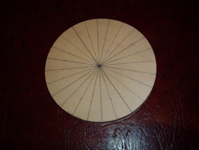

    While working on the Window like motor, I had an idea of a gravity wheel and since I'm taking a little time off the motor project pending a few tests of efficiency and just thought I would give it a try. I have done intensive research in the last few days as if it has been tried and found nothing like it.

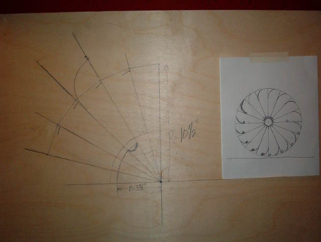

    So I did a few drawings, measurements and pondered on how to best make it happen. Here are a few pictures of how I intend to build with steel binding straps and 5/8" ball bearings.
    Any input on it would be greatly appreciated.
    Thanks for looking at it and take care all,
    Michel

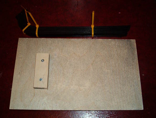

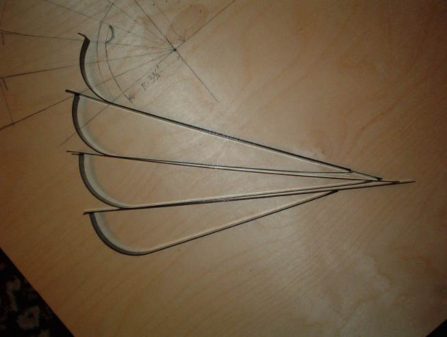

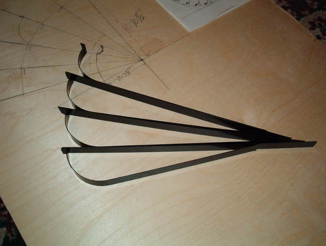

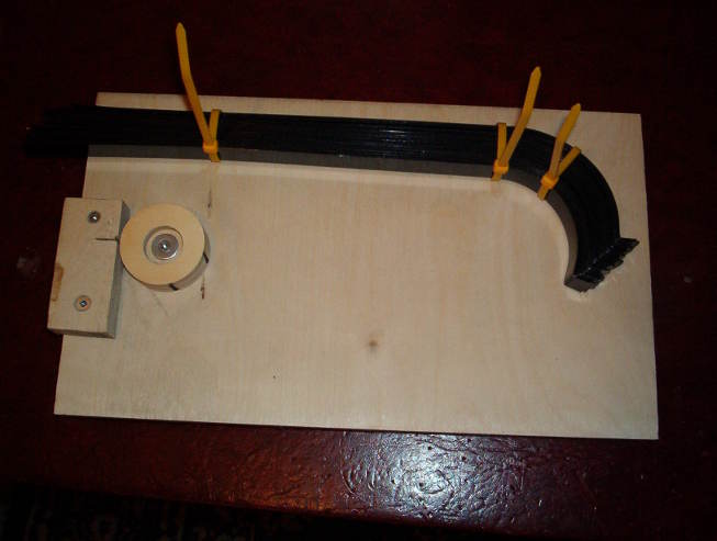

    Jig used for bending.
    Hi everyone,
    Just a few shots of the tool I made for bending the steel straps. The round part of the jig is 1 15/16" and was cut with a 2 1/8" hole saw. I made 26 bent straps and plan to use 24 around the circle. The backing will be of 1/4" birch plywood and the facing probably from a piece of 1/8" smoked Plexiglas I have in stock. I also plan to make a 3/4" hole in each section so I can add or remove ball bearings for tests. The center hub will have a radius of 3 3/8" will be notched to receive the inner strap ends and I also plan, as of the sketch above, to round the part between the notches and apply a small rubber pad to cut down the noise. I will use 2 sealed ball bearings, washed and relubed with light oil.
    The piece of wood screwed in the back is for holding the jig in the vise.
    Take care,
    Michel
    As always, feel free to replicate the design if you find it interesting.

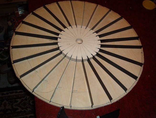

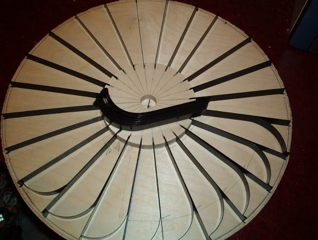

                    Progres update.
                    Hi everyone,

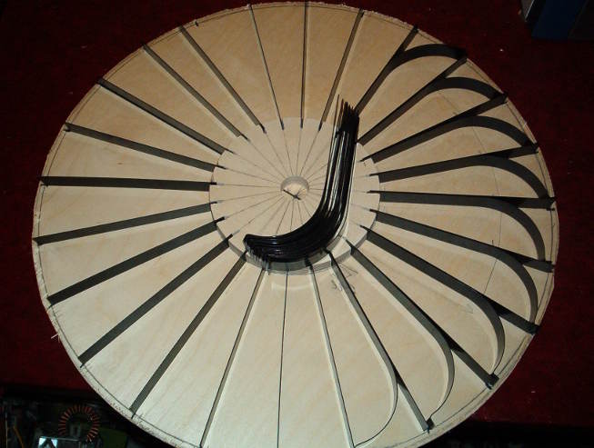

                    I finish cutting the pieces and tried the steel strap pieces for fit, looks good so far. I'll grind the ends as to remove any burs from the cuts and will assemble the parts and glue them with hot glue and black RTV gasket maker (Oil resistant silicone gasket maker) for added strength.
                    I also have to sand the rotor circumference smooth with my bench sander. The hub is drilled for the 2 ball bearings and when all that is done, I will build the support and cut the Plexyglas facing.
                    Take care,
                    Michel
                    The first picture is the hub before it was notched.
                    The three other show different parts fitted on the rotor back plate and in the center hub.

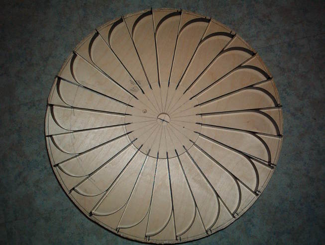

                      "Flower Power".
                      Last picture before I dismantle it for the finishing touch. It does look like a flower.
                      I'll name it "Flower Power" for the bits of hippie left in me.
                      Peace and Love,
                      Michel

                          Originally posted by Inquorate View Post
                          Quite a look of nautilus, the sea, and the golden ratio..
                          Lovely workmanship.
                          Thanks Inquorate, it does look good, I just hope it works even slowly.
                          I have to make a good balancing act now and really reduce the drag from the bearings but that is part of the game.
                          Take care,
                          Michel
