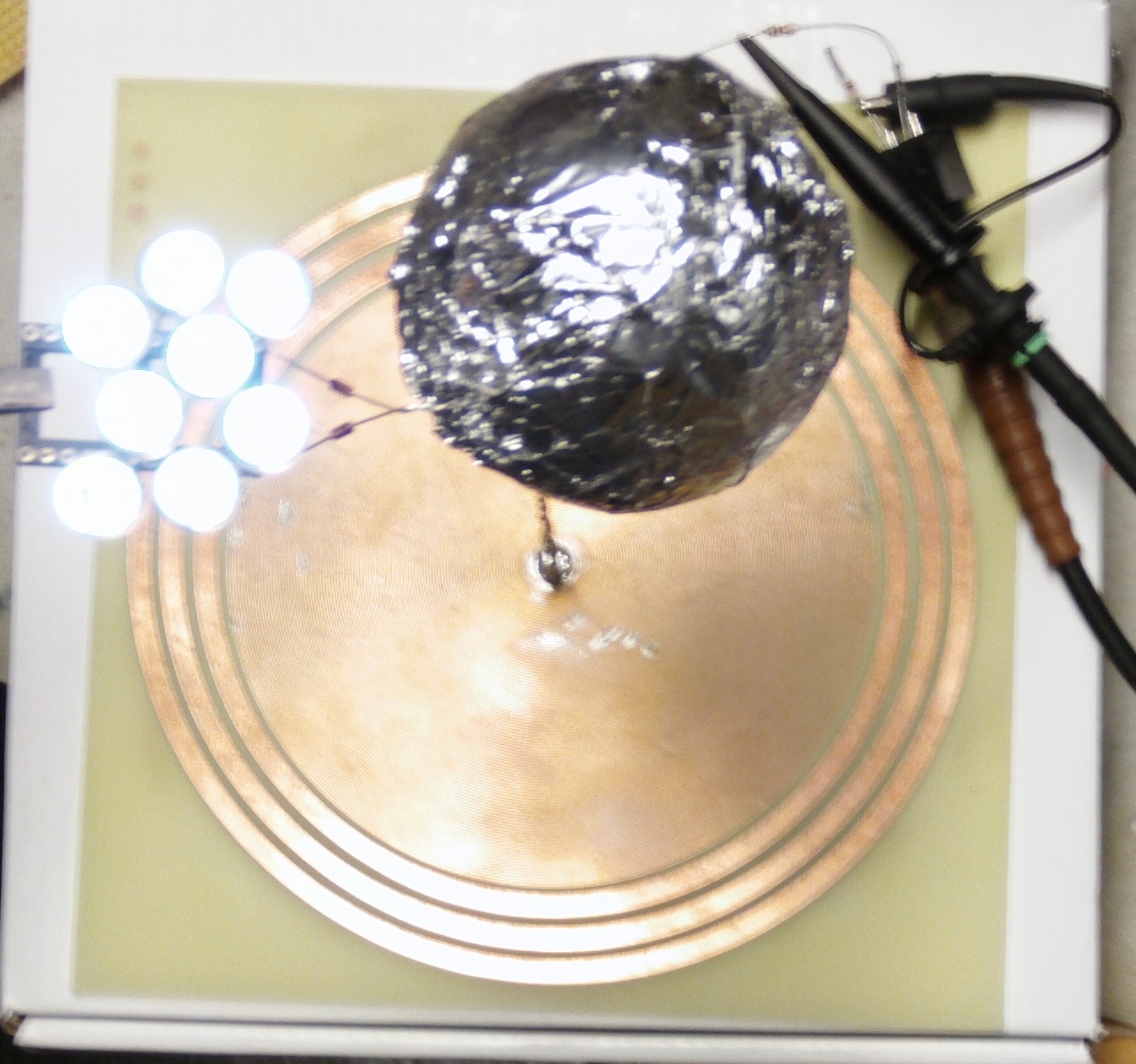

                          • @All
                            My previous post was not meant to be rude, I would just like to see a little more interactive help between the participants as seen on other threads. If anyone felt insulted, please accept my excuse.
                            @Doc
                            My biggest problem is probably that I'm more often than not have success first attempt inside my competences. Being a newbie at RF, I have had to learn the tricks of RF and test my understanding during experiments. Compared to my normal activities, this has not been so easy as I could wish. I'm slowly getting into the game. I guess I have to be a little more patient, It's not that long ago I started working on the SEC, much to read, see and understand.
                            When I joined the EnergeticForum one of the first things I posted about was Meyl. I was very impressed by his videos and documents, and I have had the pleasure to try his boat set myself during a lecture.
                            I have cheated with your replication challenge, because of the coil with 12m wire is a bit tricky to to get to the right resonance.
                            As a start I instead took my home made spiral coil PCB with a alu foil covered Christmas tree ball (bought several sizes last Christmas).
                            It resonates nicely at 2.64MHz, [email protected], approx 10mW fed one wire from my signal generator through a 1k resistor to the beginning of the inner fine spiral.
                            I have 8 10mm LEDs fed from the AV plug at approx 1/3 of full brightness. I can also light 32 LEDs but not as bright.
                            The loss is quite small with this PCB coil.
                            Maybe I will scale the coil to match the SEC, it could be worth a try.
                            And thank you for the offer.
                            Eric

                                Tecstatic,
                                I was only able to make a successful rep because I invested
                                in a digital LC meter. Its a must, you can only do so much with
                                the geometry. It does get you in the ballpark the rest is tuning.
                                But matching components is made much easier with the LC meter.
                                I can connect it to the circuit board and measure all the way to
                                transistor or cap socket which is always greater than the coil alone.
                                I don't have a power supply, I don't have a counter or a function
                                generator, My o-scope is all tubes and only good for 1us per
                                centimeter on screen. (good only that its all tubes and works)
                                And, deciphering the cryptic info that's available from the leaked
                                diagrams and what I could remember a year+ ago when the Doc
                                first posted on ou.com.
                                And lets not forget the videos tho the steps are larger there.
                                That's how i got here, the rest is time and a little bit of capital.
                                Its difficult for me to discuss theory, Voltages, frequency's and
                                such when I cant measure anything on the functioning circuit...
                                But I admit this topic has my full attention now
