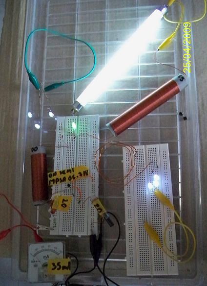

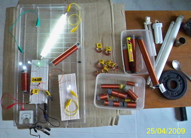

                • Hello,
                  at last I get to start again my experiments with the SEC of Dr. Stiffler I couldn't wait to be back to my country first, after viewing Dr Stiffler, Lidmotor, Slayer007 and Wavefront101 latest videos !!
                  Now I just want to give my first results before experimenting deeper.
                  While waiting for my 6 different kind of MPSA06 ordered at Mouser (and some small supercaps), and traveling half the world just for me , I decided to try the circuit with local bought not branded 2N2222 and KSP06-G12.
                  To my surprise I was able to light nicely a 6W Fluo Tube on the first trial. and LED strings with AV plugs.
                  A 2.3 Volts, 4.7 Farad supercap charges very slowly on an AV plug with a small wire 'antenna'; something like 0.01 Volt per 2 minutes So Lidmotor idea to get it charged through a JT type circuit looks great !!! It seems to increase the power obtained ...
                  The specs for that first setup:
                  - transistors 2N2222 and many other MPSA06 (On-Semi and Fairchild)
                  - input 20V from wall adapter
                  - around 35 mA
                  - L1 (tunable) is 20 turns #24 gauge around plastic pipe with 6mm diameter ferrite rod inside for tuning
                  - L2 is 20 turns #24 gauge wire cliped and made loosely around a 15mm diameter tube (I tried larger diameter for that coil, same turns, but results were lower) (I tried 25 turns and get lower results also)
                  - L3 is 100 turns #24 gauge wire around 15mm diameter PVC water pipe
                  (I tried 65 turns and get lower results, 130 turns and get lower results)
                  - L4 is 165 turns #24 gauge wire around 15mm diameter PVC water pipe
                  (I tried shorter and longer coils but get lower results on this setup)
                  ## This remarks are about the setup shown on the attached pics.
                  I have no oscilloscope to see any difference between the different transistors.
                  # Results get a bit brighter than 2N2222 with the MPSA06 (may be 20%), On-Semi giving slightly better results than Fairchild ones.
                  # If I touch the end of the 6W tube to one leg of the neo bulb, the current drops a bit and the tube is a bit brighter.
                  # If I connect wire out of L4 to end of 6W FL tube, it gets a bit brighter
                  # I burnt a few transistor while trying to connect/disconnect coils or other parts without cutting power. I f I off the power before changing parts, I don't have this problem.
                  That's it for know. I'm very glad to have it working, at least giving me nice light for now Thanks Dr Stiffler for sharing your circuit we us
                  I can clearly feel the vibration on the back of my hands while moving around the circuit.
                  Interference with TV (handphone TV) has less than 1 foot radius with the 2N2222 (not try yet with other transistors)
                  Thanks everybody for sharing and giving us a chance to replicate your works.

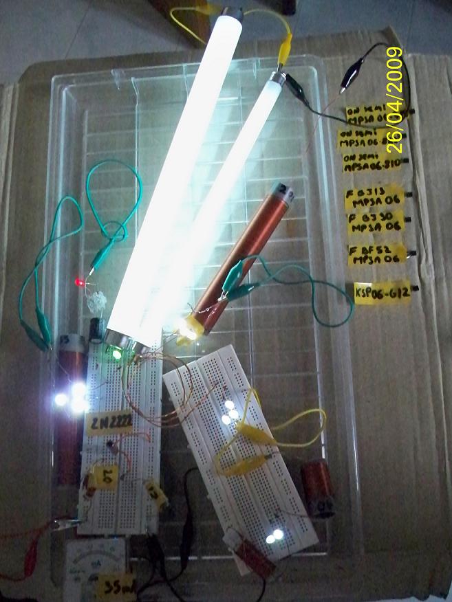

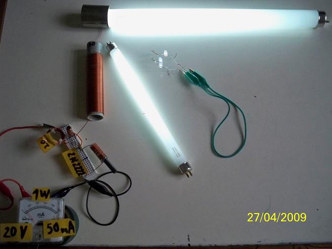

                    • Hello everyone,
                      I continue experimenting with a 2N2222 on my SEC replication, because it's interesting to see how far it can go, no ?
                      Today I should start investigating the large 'broadcasting' setups; ping-pong ball and loops of wire ... Now only AV plugs and extremities of L3 and L4 are 'hot'. I want to have a larger 'hot' area.
                      Increasing L3 and L4 coils, I'm now able to light a 8W + a 10W Fluo Tubes + a few LED wireless (I can add more LED but don't have enough yet) :0)
                      It made me very happy Tubes are lighted fully, without seeing the wave patterns.
                      It runs since yesterday (already 15 hours) without slightest problem, very steady setup. I found the sweet spot where I have much brightness for less current, and where I can wave the hand around the circuit without slightest variation in lightning.
                      L3 (out of transistor) is now 165 turns #24 gauge.
                      L4 (out of AV plug) is now 200 turns #24 gauge.
                      I'm sure it's a few watts of light, from 0.7W input (20V x 35mA)
                      The room is lit like if there was a large TV screen running in.
                      # right of picture you can see the list of MPSA06 I tried with the same results as with the 2N2222 ... with small Fluo Tubes as load I can see a bit more brightness using On-semi MPSA06s (may be +20%), but with the 2 bigger tubes (10W+8W), I can't see much difference anymore ... of course I have mow equipment here to measure anything seriously.
                      # left of picture, the red LED is connected to a supercap (2.7V 4.7F) with an Av plug. The LED is normally bright and the supercap keeps a voltage. Starting at 1.9V 12 hours ago, it shows now 1.6V.
                      My estimate is that the AV plug can collect around 15-20mA to light the LED.
                      I would need may be 20 of them to run my SEC in a loop ...
                      It's an evidence that this circuit is the winner of the decade and I thank to much Dr Stiffler for sharing it with us. (Dr. please don't go anymore on OU.com, you know they drive you nuts everytime, it's full of unrespectfull guys there)
                      @ Thanks Slayer for the tips, I saw that on your video ! 100 V in a few seconds, very good. How to collect that energy ? I you put a load on it, how much voltage you can keep ?
                      I will also try to charge a 9V battery. If I can double the voltage of a 9V battery I can use it to supply the SEC's power. It's an easy and cheap power supply, and it could be easier to recharge at the same time...
                      I will also look for small solar panels like Lidmotor is using, because I get a lot of free light with my SEC
                      Thanks everyone for sharing,
                      God blessings,
                      MDG

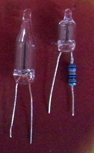

                      • Hello,
                        Just to tell that I found my circuit working much better, more power and much easier to tune, with the kind of small neon bulb with a resistor/choke of one of its leg. (I don't know if it's a choke or a resistor, sorry)
                        Whatever on which side is the resistor/choke connected on the AV plug, the power out of the SEC is the same. See picture below.
                        The bigger standard one gives me lot of troubles to tune the SEC ...
                        With both I can't light both sides of the bulb.
                        Also they are not very intense like I can see on others pictures. What to do to increase their brightness ?
                        I still working with the 2N2222, and I got same results with two other kind/brand of 2N2222 I just bought.
                        I think I have the SEC effects, high voltage for neon bulbs and fluo tubes, energy at distance with AV plugs picking up energy for LEDs and capacitors ... so it seems that 2N2222 is working for me
                        My supercapacitor (2.7V, 4.7F) keeps a steady 1.62V charge (wireless) while lighting the red LED (it's no more going down in voltage)

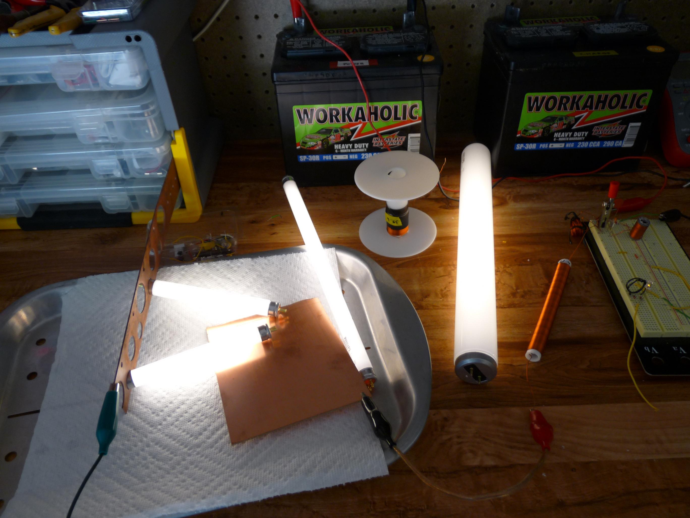

                        • SEC----wirless energy transmission
                          @Everyone--- I have been sidetracked working on a strange Bedini SSG. It is run with one "egg" shaped magnet spinning on end. Jonny Davro's thread: "One magnet no bearing Bedini" is where the work is being done. It can run on very low power so I have been tying to get the SEC to run it wirelessly. I have been having pretty good luck with it but it is still not able to run 100% off the SEC wirelessly.
                          @Steverafreter---I have been following your work and surprised to see that you got a 2n2222 to work. My cheap Radio Shack ones didn't work. By accident I found that my 500mA 12v wall outlet charger would run my SEC without a battery in the middle. The unloaded output of the little "wall wart" is 21volts just like my solar panel and the SEC really likes that. I am running the SEC on it without the filter at the front of the circuit and it seem to do fine. I found that if you up the voltage then EVERYTHING comes on much brighter encluding the neon. Just like you, I can run it for hours now as long as I have a heat sink on the transistor.
                          @ Dr. Stiffler---I still don't understand what is going on here but I am enjoying the ride. Thanks again for sharing.
                          Here is the video of my latest work with SEC wireless energy transmission and trying to get it to run the Bedini.
                          YouTube - SEC------ Wireless Energy Transmission

                              Thank you stephenafreter for posting the pictures and specs, very helpful.
                              Some info for the pictures below :
                              I found some 3/8" tubing and wrapped a series of coils for L3 the one that worked best was 5" , about 200 turns and 61uH. Input is 12v battery @ 70ma. L1 is about 46uH and L2 about 6uH.
                              L3 is connected to a copper clad circuit board, there are two 4w and one 8w resting on or near the board. The 14w FL is between the broiler pan and L3.
                              The metal plate on the left is a copper pipe support I found at the hardware store and is connected to a heavy duty metal shelf that sits on the garage floor. This is my "earth ground".

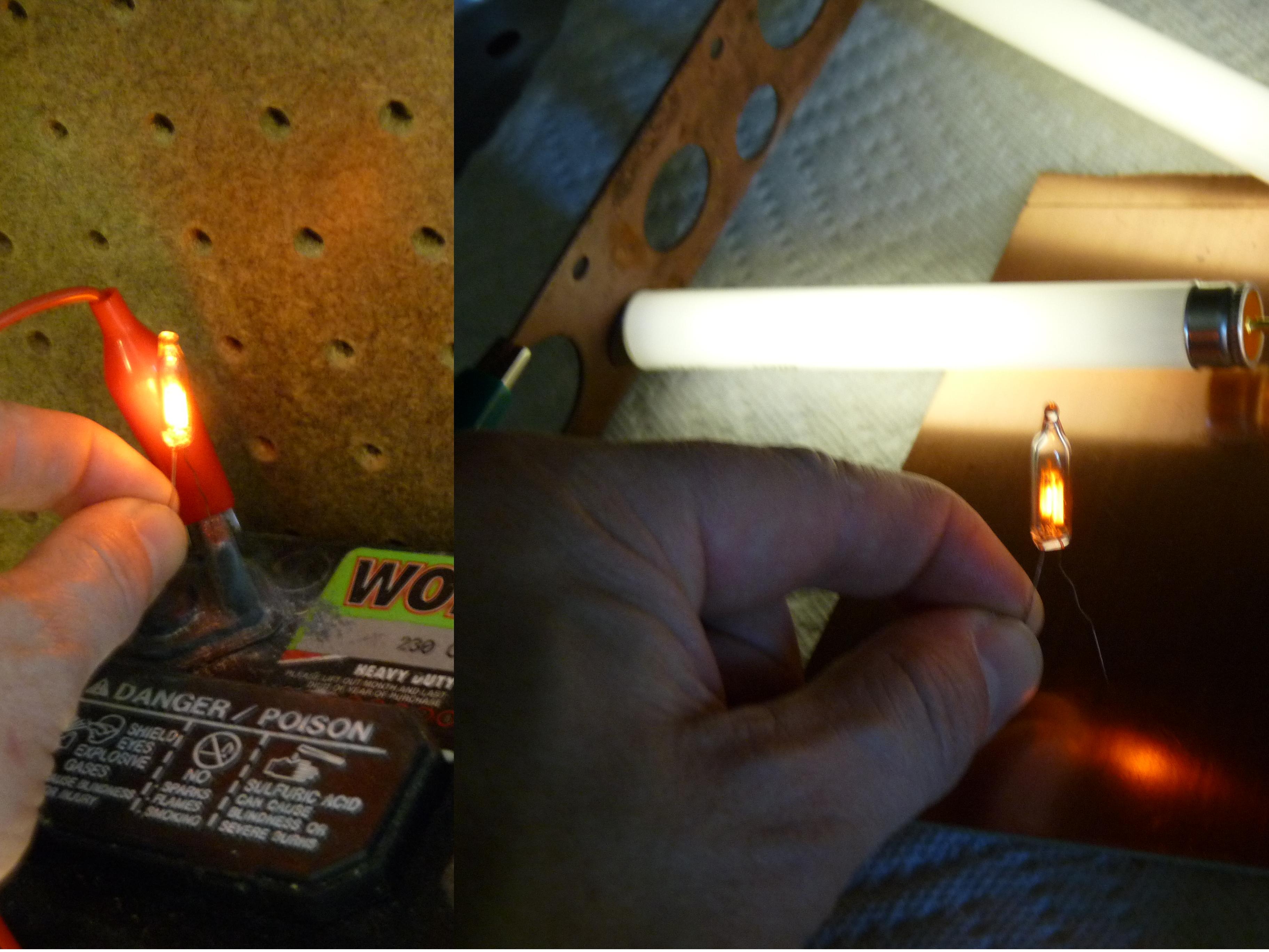

                              A neon bulb will light from the copper plate, broiler pan and both battery terminals. A small loop of welding rod and some diodes will light an LED from almost 4 feet away.

                              • Hello,
                                @ MGC,
                                I'm impressed by the number of Tubes you can light at the same time !
                                Is it because of your large alu plate, or because of the ground wire ?
                                I'm going to try to make a large 'capacitor' like yours (the alu plate + the copper plate), but with 2 sheets of alu foil. it might be very important
                                I found the quantity of energy kind of limited, because bringing a load will take the energy of another one. Can't find real broadcasting without interference from other loads yet.
                                Still working with 2N2222, burnt 3 only in 36 hours :0)
                                I found using alu ball or metal pipe for broadcasting allows for a larger field (I can bring a lit tube far from the hot spot), but still the amount of energy available seems to be the same ?!?
                                Must be careful with this broadcasting elements, because they seem to bring the ampere much higher, sometimes in the 200mA range!!
                                @ Lidmotor,
                                Great new video as usual
                                When you get the 2 LEDs on, those sitting on the chair with the antenna, do you see an increase in ampere consumption ?
                                I find sometime, or at certain places on the circuit, that a new added load, even wireless AV plug + 3 LEDs, will increase or decrease amperage (most of the time added load will increase amps).
                                Lid, you are right, 20 volts give more light I was thinking of a voltage doubler on a 9V battery that could give in the 18Volts; should be good enough ?!? A battery should be easier to 'recharge' from the SEC
                                I'm wondering what Dr Stiffler tricks are to decrease much the amperage ? He said for a few circuits that he was using around 10mA
                                I'm trying different sizes of L1 (tunable) and L2 to see how it affects the amperage.
                                Dr is using a standard ferrite rod in his L1, looks like a 6mm diameter one (like the one I'm using) so it might not be the crucial point.
                                So the trick might be in his L2 ... I saw some look quite big (lots of winding, small diameter) on some of his latest videos ???
                                Good luck all,
                                MDG
                                The picture: 1 Watt in (20V x 50mA), no AV plug, small SS pipe directly connected from L3 (130 turns #24 wire). 1 tube 10 W + 1 tube 6 W.
                                I cleaned my place and decided to start simple and going step by step, trying to understand how it works Anyway I have already a kind of very efficient lighting device, no ?
