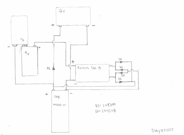

                    • Here is a short video using two rechargeable 9v batteries to run the exiter's to charge a big 12v battery.
                      The negative side of the run battery is going to the positive side of the cap.
                      Then the negative side of the cap is going to the negative on the exiter's.
                      Both exiter's the L3 coil is replaced with an AV plug that is also going to the cap.
                      Then the power from the cap is going through a diode to the charge battery.
                      After around an hour of running the charge battery went from 12.0v to 12.54v.

                        • @slayer007
                          can you post a diagram to explain your battery charger using SEC, please?
                          Fausto.
                          • Originally posted by plengo View Post
                            @slayer007
                            Fausto.
                            Sure can Plengo.
                            Sorry it's just a crude sketch.
                            I'm using two Sec Exiters but it should work with one just fine.
                            The Exiters have no L3 coil and have the AV plug in place of L3.
                            EDIT : D1 you can use other diodes. This is just what I had sitting around.

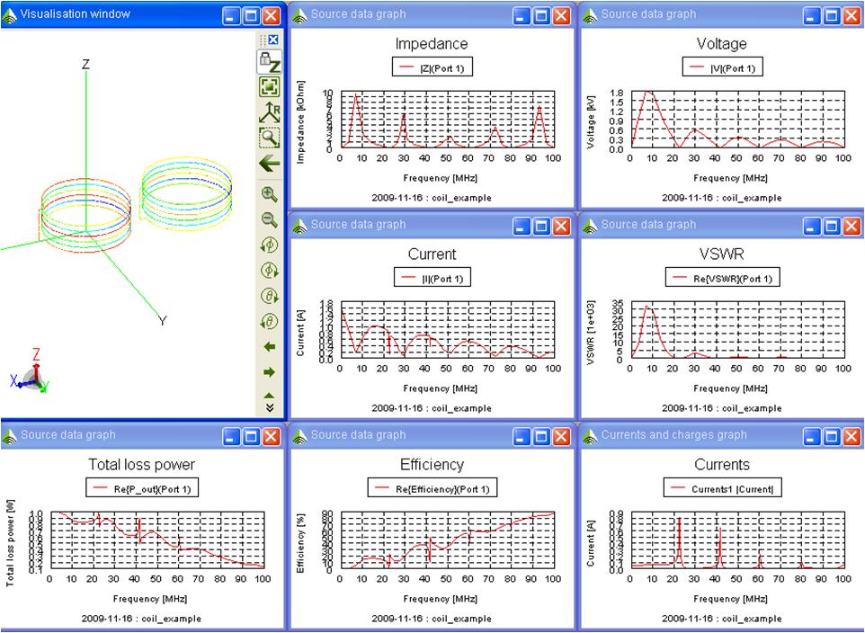

                            • Dear All,
                              In order to couple transmitter and receiver with Strong Coupling Method,
                              We need high Q transmitter and receiver. In order to design high Q RF coil,
                              we need to include skin effect and proximity effect on the design phase.
                              Main parameters are, wire radius, coil winding seperation, coil radius and most importantly wire length-> number of turns.
                              Quarter wave resonators give maximum voltage on the end of the coil, there are upper frequencies other than base frequency to have same resonant activity.
                              Please find attached FEKO analysis designed by me for 10 Mhz.
                              I have also prepared a simple Excel sheet in order to calculate Q factor easily.
                              Interested researchers are welcomed to ask for this excel sheet.
                              Please PM for it.
                              God Bless Humanity.
                              Since we all belong to him.
                              Nuri Temurlenk, Turkey
                              • @slayer007
                                Interesting how only negative pulse is fed back to source input while positive goes to source battery.
                                and it also looks like the SEC has 12v on the - side and 18v on the + .
                                I would have never thought of wiring it up like this... Hmm!
                                Can you see if it will work with less input voltage? Might need to be re tuned. Also I didn't think adding another SEC would increase power, but it might, I am not sure. a 1 hour charge beats the snot out of my solid state Bedini. Interesting. Like always. I would imagine the cap on the charging end is necessary for the counterbalance action...
                                Do you think SEC can condition batteries like that?
                                Thank you for your generosity :-)
