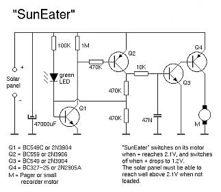

    This page BEAM Robotics Tek - The SunEater Series describes plans for small solar cell powered toy cars that measure their caps voltage and runs when it gets high enough, and shut off to charge more.
    These models work well (they say) at voltages from ~2.5 to .7 and can power an inductive load. The only problem is I can not use their advanced schematics because I am dealing with a much more erratic and higher voltage, which would burn out some logic chips... but we might be able to use this as a guide...
    I am asking anyone if they can come up with a higher voltage variant of this. To be honest I am learning more about electricity on this forum and DIY then I am in school... But there is still alot that I dont know, especially with microchips.

        @Aromaz: That air antenna sounds like a good idea. I would imagine that it is like you said all volts and microamps... But the design "SunEater" charges up a cap, monitors its voltage, and discharges when it can move a motor atleast a step. In essence its a tiny solar panel powered car. Of course they cant pull much of a load other then themselves, but if I could turn it from a car to a fan, I could ventilate spaces with "free energy"...
        Right now I am content on calling the ground waves free energy. So if I can get them to do something more then be cool on the O scope and light LED's I will imagine I am progressing atleast.
        But the real request and reason I put this on the forums is how do you tailor a specific pulse just from caps and inductors... like if you wanted to pulse 14 volts exactly when a cap fills up. That question stumped all my electronics teachers who could show me combined ohm loss or total capacitance but actually had no idea what exactly they were. I'm not saying I know everything, but when I can stump my teachers, that's a bad sign.
        You would need to sense the voltage in the cap, which would discharge it when it gets high enough, so the circuit would have to sense it periodically, ala suneater2. But the suneater circuits are calibrated for a lower voltage more current signal then the ground rods give me. I guess its time for me to shut up and make it already :-) But I just wanted to know if there was a formula for capacitors charge/discharge. (example. you need XXXnf XXvolt capacitor with XXXX for 14v discharge when voltage gets high)
