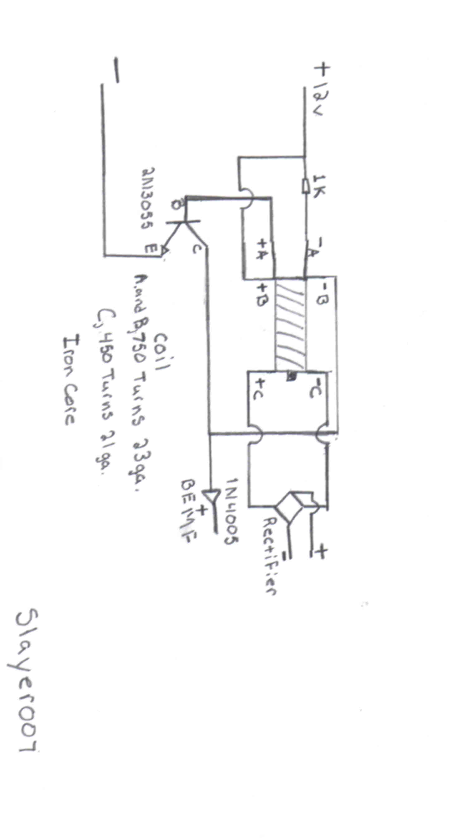

I got this idea after watching Lidmotors latest video.
This is a basic joule theif circuit done with a big coil.
The coil I used is a trifilar coil.
It has a 23ga. bifilar winding 750 turns.
Then a 21ga. 450 turns wound on the out side of the two 23ga. windings.
With an iron core.
The + is the start of the coil and the - is the coil ending.
The interesting thing is when its running to place a magnet on the front of the coil.
Then it really takes off and you can hear the coil screeching.
