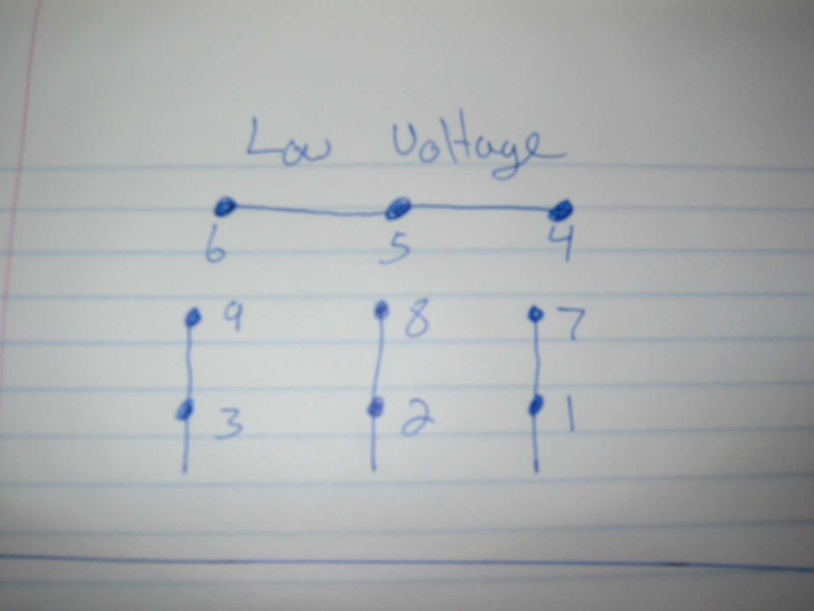

    Right now it's hooked up as the second image img 16. The one where the wires #1 #2 #3 are by themselves. The high voltage diagram.
    Now from here how do I check the coils with my ohm meter to make sure the motor works.
    And also I want to use 230 voltage so i think I need to wire it up like the first image. Low Voltage. But once it's wired up like so how do I hook it up to a 240 plug. I need more info before I fully understand how it works.
