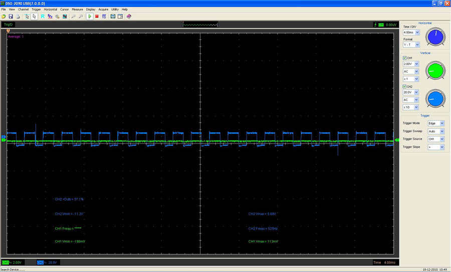

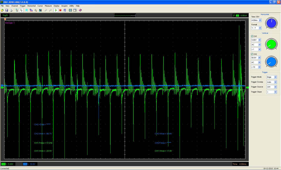

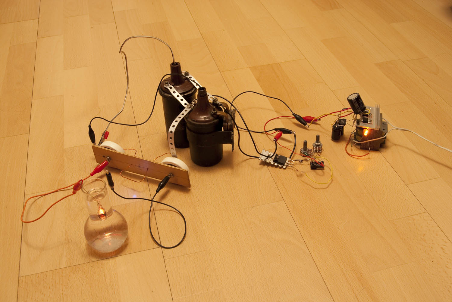

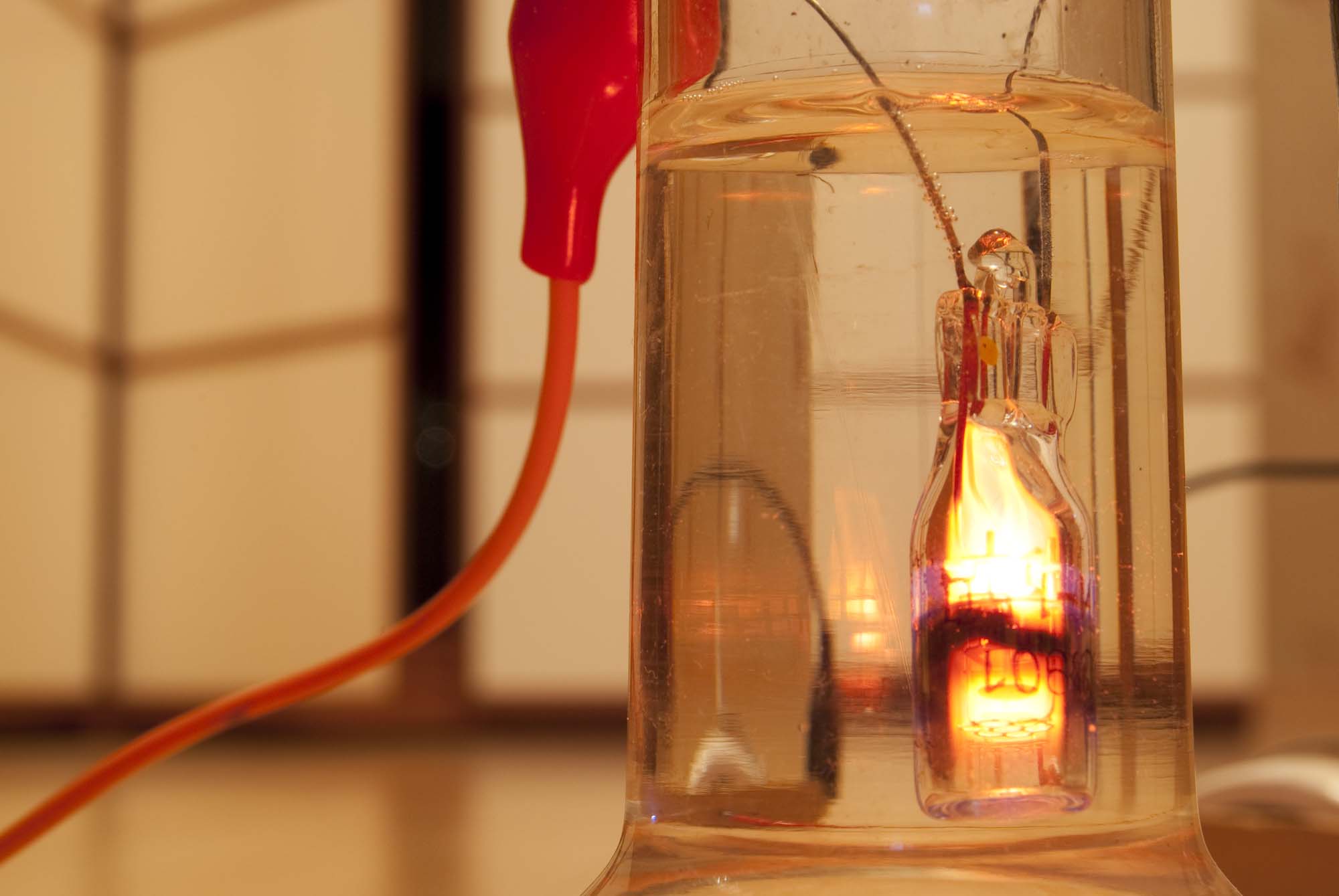

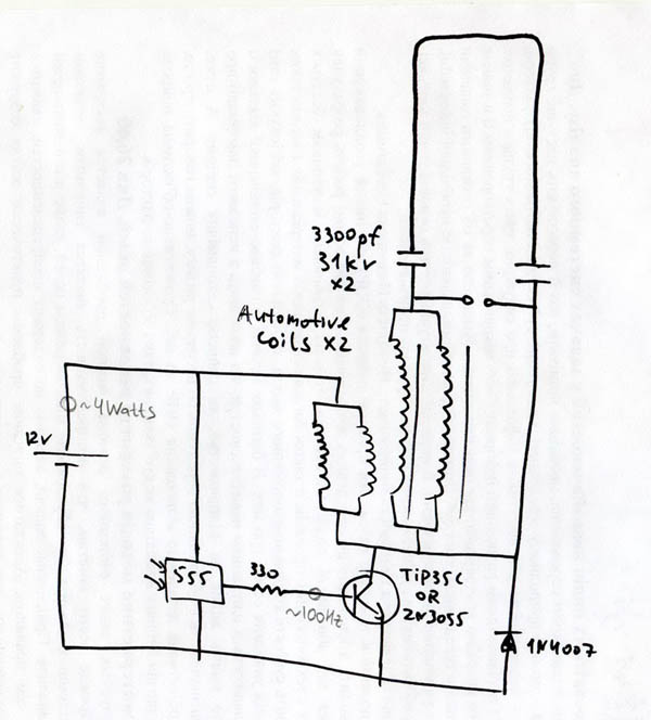

Decided to build a low-power Hairpin. It consumes only 4 watts and produces enough radiant energy to power 100V neon bulb. The same effects noted above are observed.
Also one additional. If we take off the glorious copper rod above the capacitors and power the bulb in the water, we would see the same light emission but plus hydrogen emission in one of electrodes. Think it proves that two types of energy are going through the same wires and that tall rod is only the filter. It simply wastes the normal electricity, providing the pure radiant energy for us. That`s what we are paying for!
But in this case I don`t get what Bedini says in "Energy From The Vacuum" that we can`t mix the radiant and hot energy.
In addition - the equivalent effect can be achieved by the circuit, proposed by Tesla in his 462418 patent "Method Of And Apparatus For Electrical Conversion And Distribution". The simple high-voltage relaxation oscillator.
The next question - how can we use it for powering the load having overunity effect. Did someone try to calculate the output and what was the achievements?
And about the rod - as far as I concern, only the length matters will it waste both energies or only hot. And the diameter - will it blow up from the hot energy or not.
If I`m wrong somewhere, please put me on the place!

Cat,Originally posted by Black cat View PostHello, dear Friends!
Thanks to Karl and everybody who are bringing Tesla`s works to life! It`s a great advance.
Thanks a lot and take care,
Mieow >:3
[ATTACH]7231[/ATTACH]
Can you provide a picture of your spark gap on this configuration ?
It's difficult to see or arrangement on the backside of the board.
Thanks,
Timm
