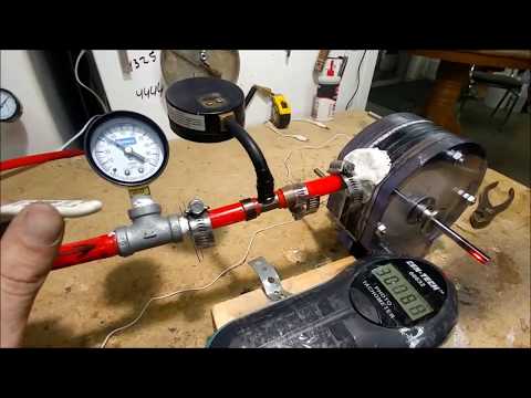

                    • Here is an example of what happens when compressed air is expanded and made to do work.
                      This "Tesla turbine variant" running on "moist compressed air" is not powering any load, other than overcoming its own friction. If it was powering something, the cooling effect would be greater.
                      Ice formation due to moisture is one of the issues to overcome.

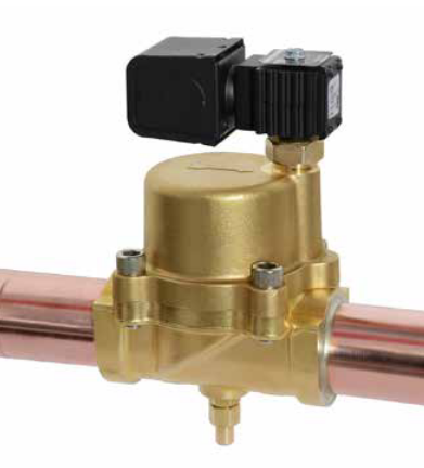

                      It appears that there is mounted on the above engine a conventional refrigeration, solenoid type expansion valve, similar to this one;
                      Click image for larger version  Name:	Screenshot_2021-10-25_23-13-39.png Views:	0 Size:	95.5 KB ID:	507848
                      Which, to me, possibly makes sense.
                      The engine SHOULD BE exhausting frosty cold air. It appears that the expansion valve is mounted close to the exhaust, with the exhaust passing through the valve. Possibly the solenoid is being controlled by the engines own magneto, which would not be needed for generating a spark.
                      If I had to hazard a guess, such a valve could be adjusted to allow a bit of very dense cold air to pass through and into the tank when the exhaust pressure is at a maximum then close as that same air just allowed through absorbs ambient heat and expands. As the air pressure in the tank then drops slightly to run the engine there would be a slight pressure drop and the valve could open allowing another stream of cold dense air through.
                      This type of closed loop air engine would not have a tremendous pressure difference between intake and exhaust.
                      It is unfortunate that the video is so unsteady and the explanation of how this engine is supposed to work so incomplete, but I think that there is reason to believe that there is a theoretical basis for operation and that it may be genuine.
                      as far as I can tell, it looks as though the original exhaust port on the engine is plugged by a pipe that terminates in an ordinary shut off valve.
                      The refrigerator expansion valve, if that's what it is, looks like it was tapped directly into the top of the engine head.
                      The idea there, perhaps, is that the exhaust is not exhausted in a normal way, through the exhaust port in the back of the engine. Probably the exhaust stroke of the engine is more a compression stroke directly into the expansion valve.
                      The four stroke engine acting as both a single acting air engine in intake down stroke and air compressor on the up exhaust stroke. No need for the usual gas engine closed valve compression or to atmosphere exhaust stroke.
                      Internally, the valve lifter was probably removed so that the valves are always closed.
                      There is no valve at the spark plug hole, used as an air intake. So, what controls the air input to the engine?

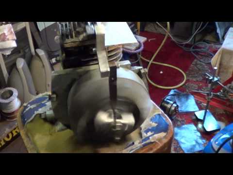

                          This air engine uses the spark plug hole for both intake and exhaust, which is probably less (thermally) efficient as there would be some mixing of the warm intake air with the cold exhaust through the common inlet/exhaust valve and piping.
                          As a result of not keeping the intake and exhaust isolated, the comparatively warm exhaust of this engine is probably nowhere near cold enough to make recycling of the exhaust back into the tank possible.
                          Nevertheless, it is a good example of one possible DIY compressed air engine intake control valve.
                          The fog of condensed water vapor at the exhaust, especially when a load is applied to the shaft indicates there is a lot of cooling, enough to condense moisture out of the air, in spite of the lack of thermal isolation.
                          A typical cast iron IC engine and metal piping are such a good thermal conductors it's a wonder there is any cooling.
                          An acrylic cylinder head and PVC pipe for the exhaust, or some other non conducting material would help prevent the potentially cold exhaust from warming up before it passes a check valve or whatever back into the tank.

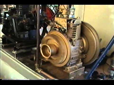

                          In the earlier video, there is a bulge in the exhaust return pipe that I think may be a check valve.

                          • Possible return line check valves:

                            • Take note that ordinary compressed air gets quite cold when it expands. As demonstrated in this next video.
                              But the effect, the cooling is much more extreme if the air is expanded through a turbine or reciprocating (piston type) air engine or motor.
                              The energy ("work") taken out of the air when used to drive a load on a turbine or engine reduces the temperature much more than mere free expansion as shown in the video
                              This seems counter intuitive. Work output AND additional cooling as a consequence?
                              The method of cooling by extracting work from compressed air, by using the compressed air to drive an engine or turbine (with a load) is an improvement over Linde's air cooling/liquefaction methodology that Tesla was familiar with and so excited about. (See for example Claude method of air liquefaction.)
