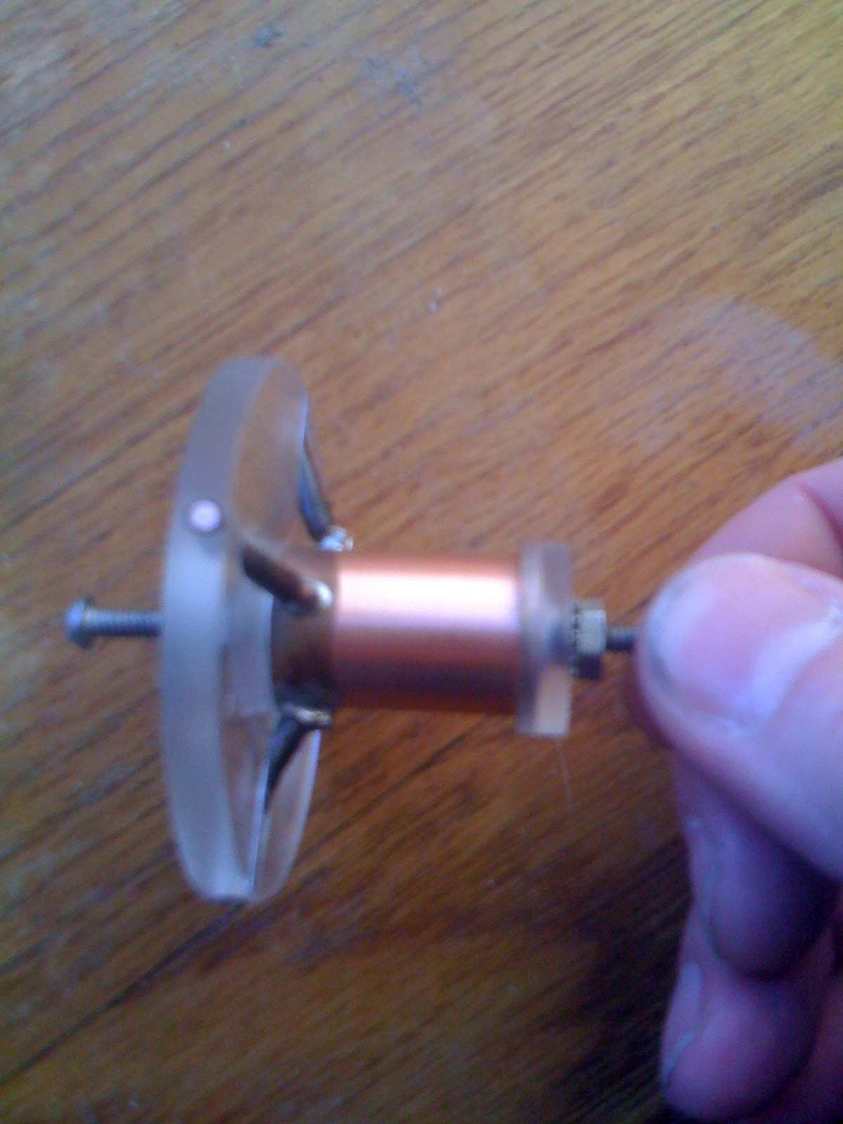

                  I have a lathe, if you have a spark gap/switch idea let me know and I'll see if I have the materials to make it and ship it to you. Here's a pic of the rotor Ive made for my spark gap. The copper is common to the outer contacts. Hopefully it will act more like a switch.
                  It's basically 3/8 plexiglass from Home Depot, 1/2" copper pipe counter-sunk and captured between a plexi end-cap and the plexi rotor. The contacts are solid copper from house wiring soldered to the copper pipe. I'll have a brush on the pipe and contacts on the perimeter of the plexi rotor.
