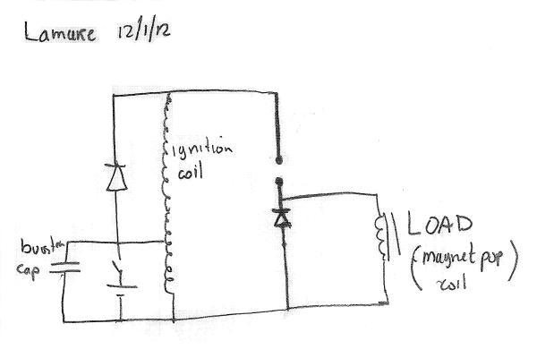

                If your theory is correct, then I think the attached schematic should also work. With this, you get a very steep pulse to your load coil when the spark gap breaks (make sure the ignition coil produces a positive HV spike; polarity of primary may be drawn wrong, I always confuse these), whereby the electric field, which propagates with either c or pi/2 times c, might energize the load coil, provided you have a steep rise time and a slow fall time of the pulse.
                Then, the diode with booster cap ensures that the discharge is uni-directional.
                The problem I have with this theory is:
                a) It does not explain why you would need grids in the CSET nor how the energy would be transferred trough the grids to the coil, unless you get an arc/spark discharge towards the grids too.
                b) It is very similar to Bedini's systems, which do produce COP>1, but are far less powerfull than what Gray was apparantly capable of.
                  I think your drawing will work. I have placed the reverse diode on the other side of the gap before for different tests. But why not just put the coil in place of the diode?
                  I do want to clarify my previous statement about the plasma not being a true disruptive discharge. It is a real disruptive discharge - even more so than a peaking cap type discharge (it is quite a big faster) or other conventional disruptive discharge. The cdi discharge into the ignition coil of course is not disruptive - but the plasma effect that follows is disruptive. Not a comment in response to your reply - just a clarification.
                  The booster cap would need to be disconnected from the primary or it is just shorted out through the windings. I always placed the booster in parallel with the gap so that there isn't too much being discharged into the primary. The positive of the primary is usually in the middle instead of the bottom but doesn't matter in concept.
                  a) You don't need grids, I think that is all bogus to throw people off. What is important to understand is that the gap you see is the same as the gap between the rods and the grids in the Gray tube setup. That gap is NOT analogous of the gap between the rods. The gap between the rods is substituted with the HV diode between the primary cap and HV. 1 - hv discharges backwards into HV diode before jumping gap - that is analogous to the HV jumping over the gap between the rods into the LV side - lv side being the capacitor. THEN, when the diode shuts off, the HV turns away and has nowhere to go but over the gap (same as going from LV rod over to grid then through coil).
                  Here is an example of the comparison between my method and the Gray circuit. The LV source I show is the booster cap - however, the CDI cap on the front is also a LV source and works without the booster cap. Recovery cap and recovery battery are just there for examples - anyway, it is a perfect analogy to the Gray circuit (with the reverse diode as Bedini shows):
