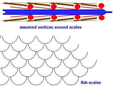

                                I have been building a simple put-put motor with a pair of jam jar lids soldered together and am learning more about the 'mechanical' action. However, the soft solder simply isn't holding out long, once I get a burnt out. It works okay while there is steam, but just not reliable enough. I need to gather my thoughts and also look at building a pulse jet as well.
                                Ref the hearts: I have attached a simple diagram showing the approx layout of fish scales at the bottom, which is also similar to roof tile construction!
                                Plus at the top is another image showing the scales [brown], looking edge on and how they overlap each other. This is my understanding of how the fish scales may be creating vortexes. I think it would be interesting to see if the top illustration would reduce friction, using in effect, two rows of scales. You'll notice it is similar to the old tapered clay water pipes that were used and which you illustrated elsewhere.
                                Maybe your half-hearts would look similar and perform better?
