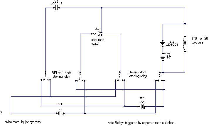

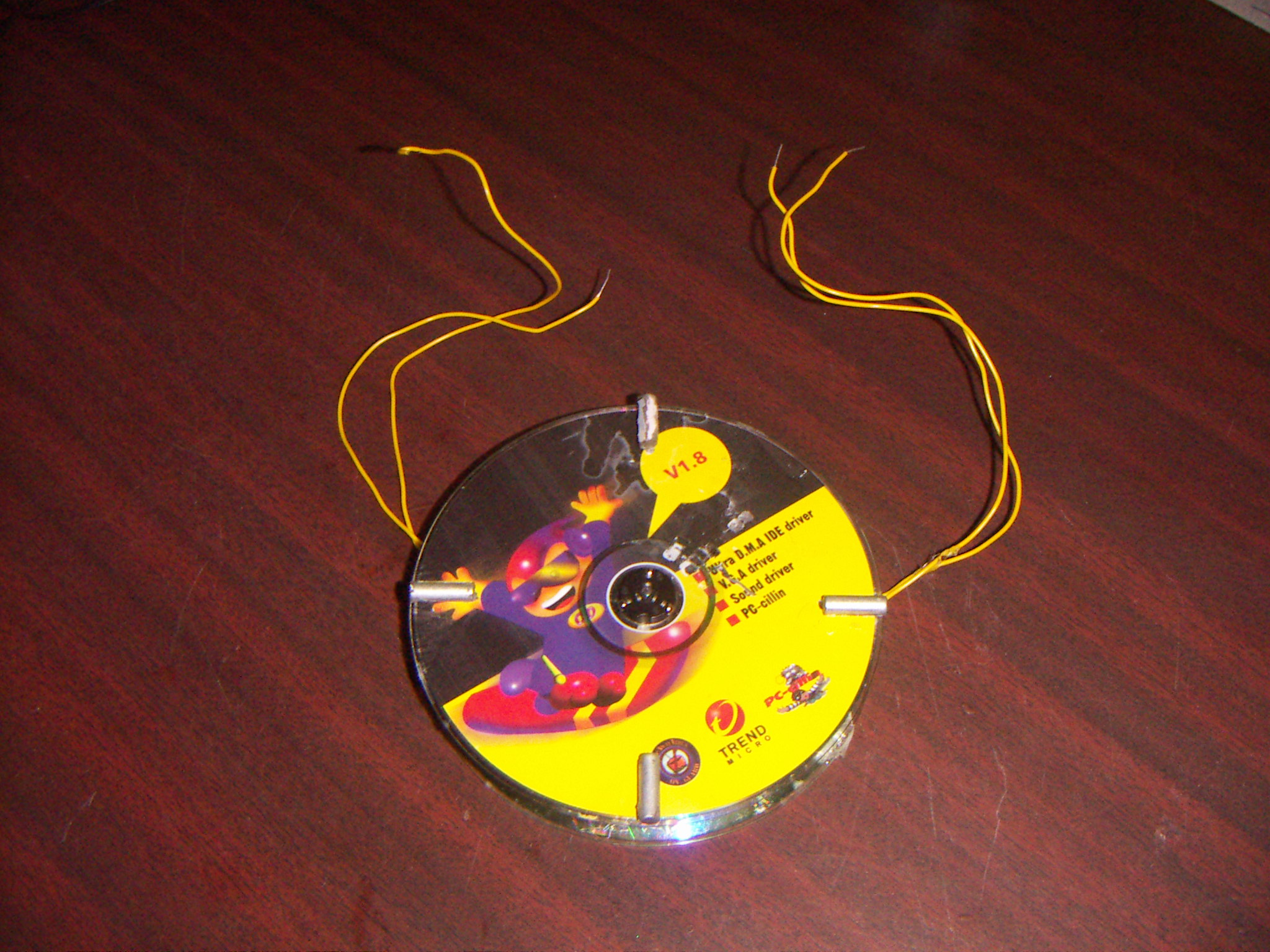

    I have attached two circuit diagrams and a picture off the rotor.The rotor is nothing fancy just a cd with 4 small magnets.The yellow wires go to two reed switches in case i have to go with my relay idea for the battery switching but i think the relays will be to power hungry so im hoping someone can help me out with an electronic alternative.
    Circuit 1 is how i have it set up at the moment so you can see it is only recharging 1 off the run bateries.
    circuit 2 is how i can switch the batteries using relays but like i said i think they will be power hungry and also there is the possibility off a dead short.

    Hi Jonnydavro,
    You have built an interesting circuit.
    On battery swap circuits: you could study some texts starting at page 156 in Patrick Kelly's PDF book ( Practical Guide to Free-Energy Devices - eBook Download )
    Hopefully you can figure out a practical circuit for your needs.
    Maybe you could use a fast recovery diode instead of the 1N4001 to catch more flyback pulse from your power coil, the 1N4000 series are very slow types. There is the UF 4000 series with the same voltage and current ratings for instance but they are designed as fast rectifiers ( http://www.fairchildsemi.com/ds/UF/UF4001.pdf ) of course there are many other fast/ultrafast types as well.
    One question on your twin rotor Bedini setup: have you managed to make some pickup coils and also use stronger magnets? Hopefully you did not give up on that.
    Regards, Gyula
      Hi gyula,Thanks for the advice on the diodes,i will replace the 4001 with a fast recovery diode.
      I have downloaded Patrick Kellys pdf and looked at page 156 and i think it may be just what i need as it shows an electronic equivalent to an spdt switch so hopefully i can figure it out.Thanks for that.
