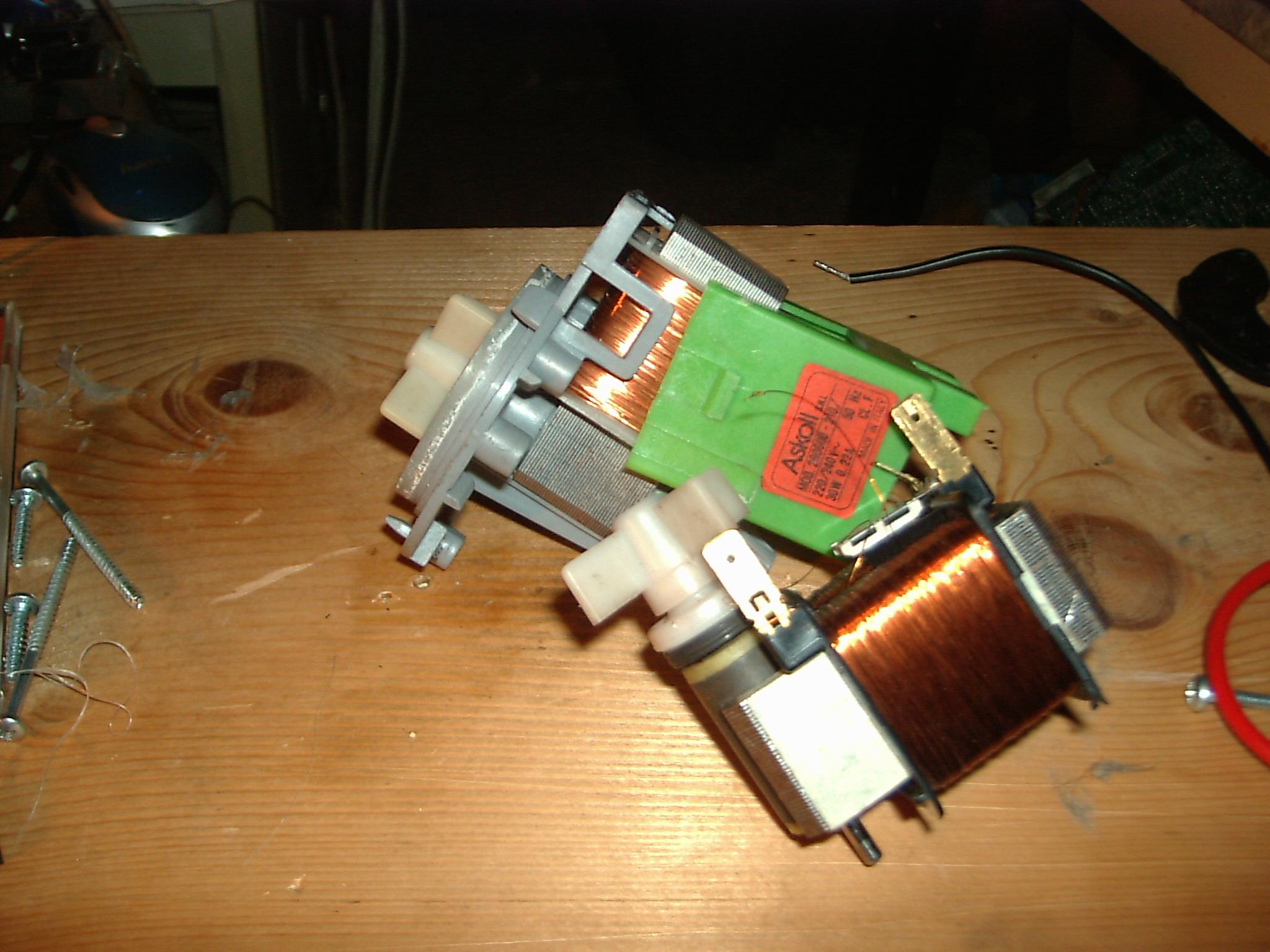

Hi Gmeat,
It was a Privileg machine, its the Brand of a Catalog Company here in Germany,
but i found the same Motor into a newer Miele or AEG Dishwascher.
The Manufactor is Askoll from Italy, and i found it at the Junkyard.
There been couple of this Machines.
The Coil is allready at the Motor, i only removed the Case and the Magnet from it.
Then i got the Core and the Coil from it.
The wire is 0,2mm ( 0.001in) and both Coils have 180ohm resistance.
The Motor runs usual at 220Ac/30Watts.
But i am sure, i could make a similar Coil from an Transformator too.
Just remove the E- sheetiron, and cut off the middle Part of the E,
to get a U, then isolate the IronSheets with Hairlack, put them together again and turn Wire left and right around the |_| now.
Isolations between the sheets cause lesser loss, because you get otherwise eddy current between the certain sheets.
And screwed together with Brass or Bronce Screws.
Thats how good Transformators are made. ( A Friend teached me that
Right now, i did cut the Wire in the Middle, and turned the Coils, to see, if that makes any Different, but seems it does'nt.
I was inspired at this from Joseph Flynns Motor and a Link in here, about the Flux at the Core.Last edited by Joit; 09-28-2008, 06:05 PM.Theorizer are like High Voltage. A lot hot Air with no Power behind but they are the dead of applied Work and Ideas.

Hi Joit,
Is there any indication as to what type of motor that is.It looks like a switched reluctance motor or a shaded pole motor,But you said there is magnets on the rotor?.I'm kind of amazed that that little motor could power a washing machine.Any more details?.Thx again for posting
-Gary
Hi again
Sorry, my fault,
the Motor is only the Waterpump. I only get it out from a Washingmachine,
and saw it at a Dishwascher too. It only Pumps the Water around in there.
But they are still a bit strong and its a AC Motor.
Some similar Pumps have a Iron Rotor, and seems, its new, to put a Magnet in. Maybe it saves Copper.
And since they make stronger Magnets, its maybe cheaper, to build them with a Magnet as Rotor
Its big like a Hand, and i did only look at the Coil and Iron anyway
And well, i still get a lot Voltage out from this Thing, but its only like Hot Air with no Power.
Either way i would connect it to the Fan, and let it run itself
(ok, i did allready tried that), but it dont works right now,
even not with transforming the Volts.
Maybe i need a other Rate at transforming.
Seems the Torque is only inside a Rotor, what brings out the Amps.
I am about, to cut some Gaps into a Rotors, and put some Wire on it.Last edited by Joit; 09-28-2008, 08:25 PM.Theorizer are like High Voltage. A lot hot Air with no Power behind but they are the dead of applied Work and Ideas.

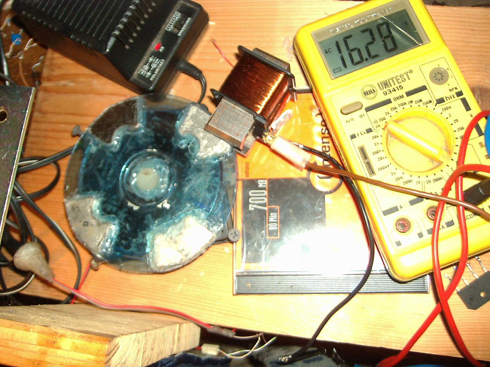

Hi Joit,Originally posted by Joit View PostHi Gmeat,
The main reason you do not get useful power from the coils is that each has the 180 Ohm copper wire resistance and this constitutes a rather high inner resistance, from a generator point of view.
So you may wish to make both coils from much thicker wire that still gives a reasonable induced voltage level with its obviously less possible number of turns but then you will also be facing Lenz law in your present setup?
Or in case you do not wish to make new windings on that core, you may look and find other off the shelf motor solutions to be cannibalized.
Continue tinkering!
rgds, Gyula
Hi,
It is the number of turns that constitutes the induced voltage amplitude, besides the the rate and amount of flux change. So to get high induced voltage you invariably would use high number of turns but in case of thin wire you introduce more resistance as well. So you would use thick wire to reduce the resistance but thick wire needs bigger winding area for the same or comparable induced voltage amplitude and now your winding area on that plastic spool is a given size. So you have to make do with less induced voltage for the thick wire case if using the same spool.
Say you got 12V induced voltage from your 120 Ohm coil. Say you load it with a 20 Ohm resistor. The current in your coil and in the 20 Ohm will be 12V/(120+20)= 0.085A or so. Now this current makes a differing voltage drop in the coil and across the 20 Ohm load. Inside the coil the voltage drop is Vc=0.085*120=10.2V and across the load the voltage drop is Vl=0.085*20=1.7V This is a big loss for the coil (10.2V times 0.085A is dissipated in the coil wire), just due to its rather high inner resistance.
If you could make a coil with thick wire that gives say 4 Ohm inner resistance only but say you could induce still a good 6V in it (with a less number of turns), then the current in the same 20 Ohm load would be 0.25A (6V/(4+20)=0.25A) and most of the heat would be created in the 20 Ohm now, a much better situation, compared to the previous case.
(I simplified the digits above a little.)
rgds, Gyula
Hi again,
Thanks for Explaining me this, very usefull.
But no good news from me, i tried to make it with 0,9 Wire, and got now 0.4 Amps, but only 0,6 Voltage. I guess, the wire was a little to big.
The other Coils, i had there did have both about 90 Ohms, when i split them.
But i see what you mean, it shows the effect very well.
I hope, there is a workaround for Lenz' Law, maybe the Trick is, not to press the Coild out, maybe you need to suck it out with a opposite Potential.

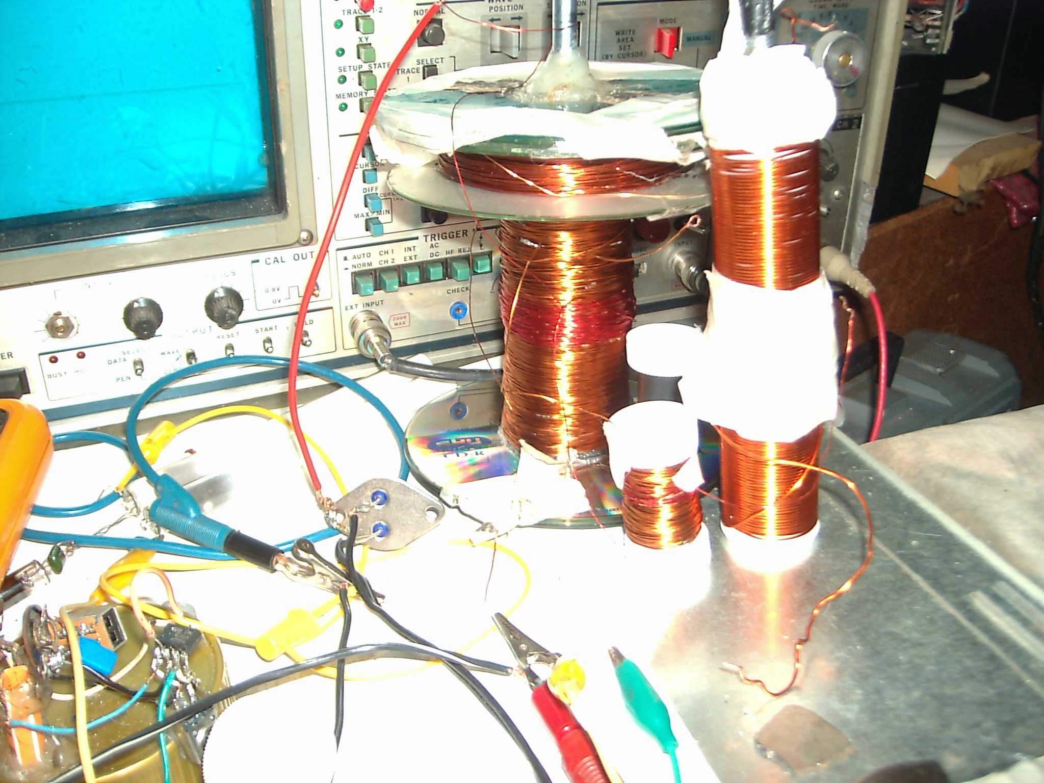

Right now, i still play around with my coils, and it does make a Different, if i face the start of the Coil to the Bottom of my U Core, or turn one, that it has start and end at the Bottom.
I attached a few windings with 0.4 mm Wire at the bottom at the U too, put the 2x 0.2mm Coils to it, and put my Multimeter at different places on it, and got one 40V out from it, when the Fan runs at 6 V.
It was like /\/\/\_||||_|||| where it was the Coil with the bigger wire, and the 2 Smaller wire Coils, i take the Current from the Point between the thick and the first thin, and at the end of the 2 thin Coils.
But still only Hot Air, what it gives out.
That way, i tried to get some Amps out, when the Big Wire Coil is Centered at the Bottom from U and the 2 Small Coils are beside.

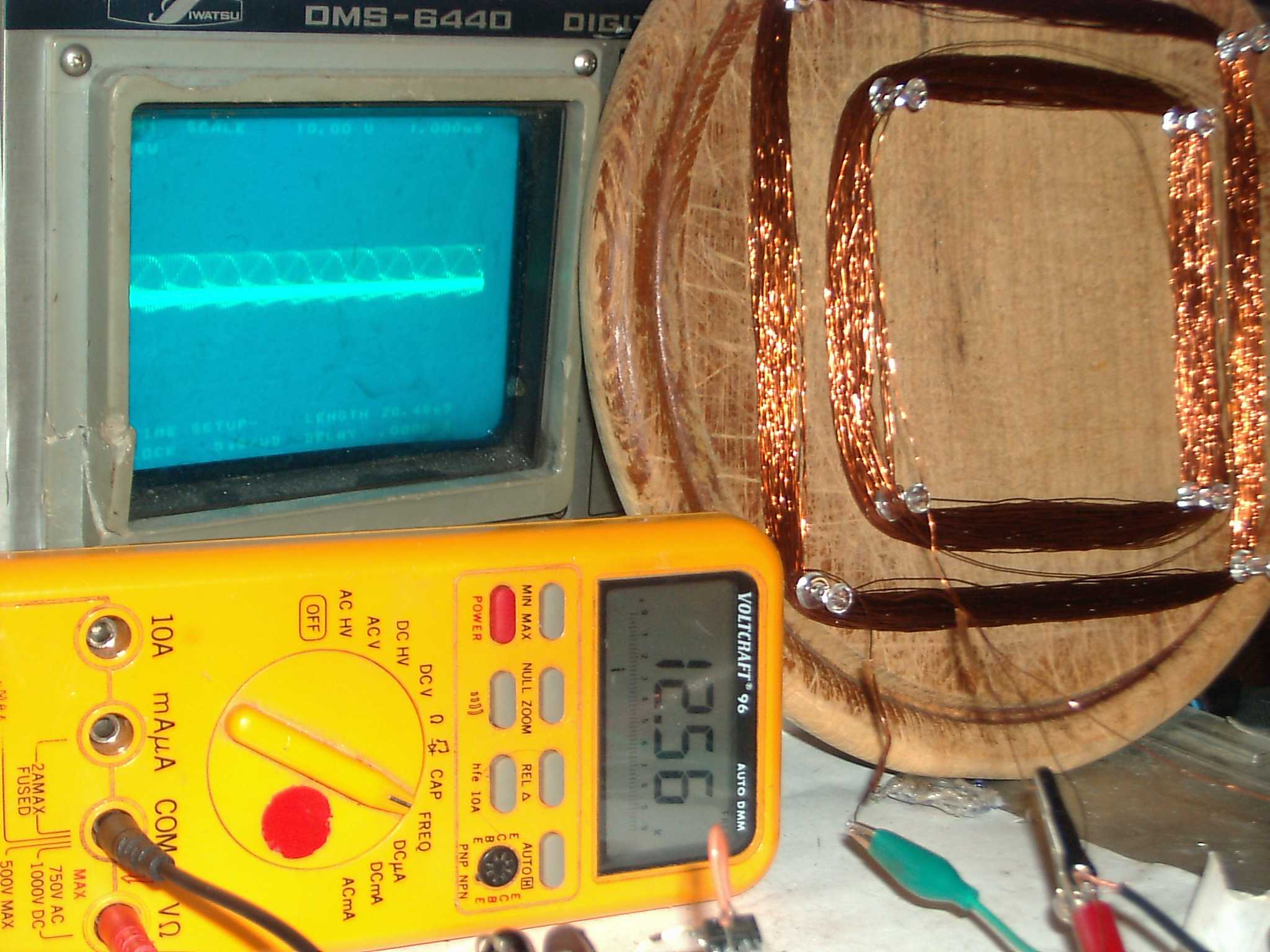

Ok Time is passing by, Coils change, and i made another Coil with a small Coil at the middle.
I like the Way to build it, anyhow simple to do, and much to play around with it.
Video
Left Picture is again the big Coil with the small one over, just some sharper (i hope) as at the Video,
this Quad Coil at Wood is a Experiment from Ou.de,
where someone want to spread this Setup, after his Theorie, it should give OU.
We want to figure it out and work on it, and he looks for rebuilder,
before the 'Copycats' wanna put her Claws on it.
Right now, i dont know, if he only has a Theorie, or some practical backround.
its the same as with my Coil, it gives Voltage, but with the Quad setup no Ah (2mA),
my guessing, the distance is to big for it.Theorizer are like High Voltage. A lot hot Air with no Power behind but they are the dead of applied Work and Ideas.
