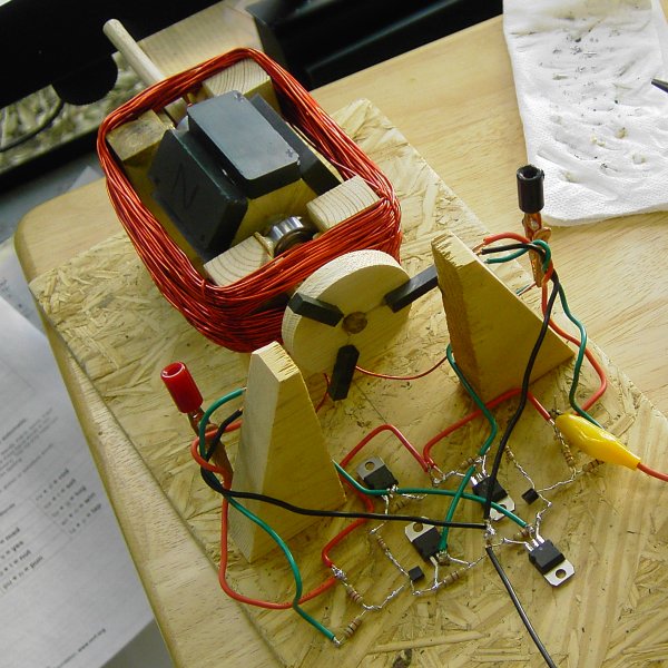

              Hi Ren,
              So what did you find with the half and full B/C circuits? I know that the full B/C fully isolates the coil when it's not firing, but I haven't found anything of interest with mine. Of course, though, mine is a POS and probably not built right, but it is an interesting concept in its own right.
              It turns fairly quick but has absolutely no torque. Mine's built with ceramics on the rotor and probably not nearly enough turns in the coil. It uses the full B/C circuit and Halls for switching. I tried charging a battery and a cap off the coil, but got feeble results--again, probably because the magnets and geometry of my build aren't optimal.
                I remember seeing yours in the monopole forums Shamus. Incase you havent seen my build have a look for the window motor thread. I tried halls but I ended up settling for trigger coils, much easier IMO.
                I wont hijack Jets thread too much, basically at the right tune when the bridge is hooked back up to the run battery amp draw goes negative for a second or so on my analogue gauge
