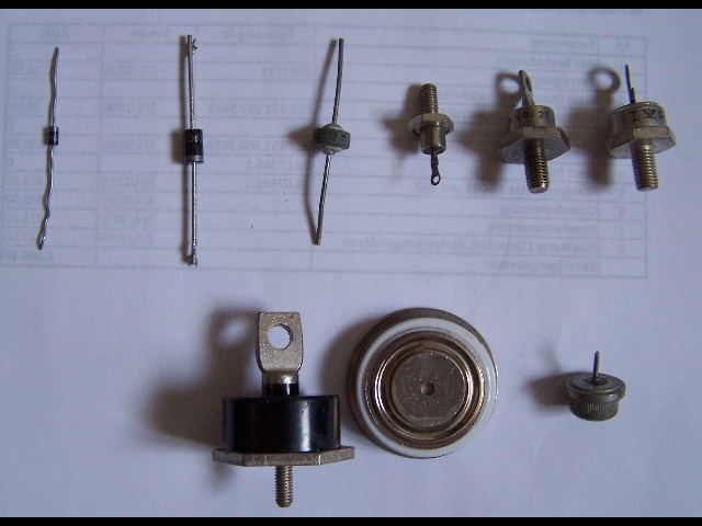

              are you sure its a 1N4005?
              A 1N4005 is a very small general purpose Diode handling only 1 Amp at 600 volt I doubt that these Diodes where or even could be used in an Alternator .
              Usually they are like 1N3493 and are press fit physically about 20 times larger.
              Unless you are taking about a diode that you used to put in line with the Cell.
              If so try a 1n3913 or others that are stud mounted and can be heat sinked
              I am enclosing a jpg showing different varieties, this may help you making your selection the smallest one is the 1N4005 Diode.

                  Try a 1N3913
                  All depends on the physical space that you have and if you can, need and want to heat sink this Diode which I always recommend.
                  I always go for bigger just in case that you need it at a later point and it won't do any harm if you use it with lower current.
                  As I mentioned a 1N3913 is fairly fast and handles up to 30 amps at 400 volts. If you can not get that Diode there are hundred of others that can be used. it is the 5th one on the upper row in my jpg, just to give you an idea what it looks like.As with all stud Diodes the Case (Stud) has to be isolated
                  if you mount it on a Heatsink usually the thermal Mica or now Teflon Washers come supplied with the Diode but not always so specify and get an extra washer if they are Mica as they are brittle and easy to Damage.
                  If you have no Heatsink Compound which you also need you can use 4X silicone grease if you get the Teflon type you can get away without the grease although I still use it sparingly.
                  Hope I have not confused you. Glad to help
