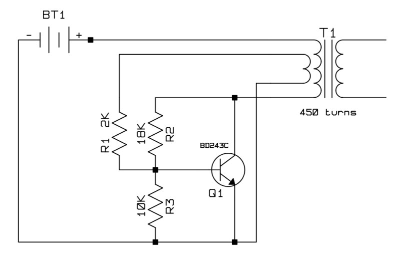

Your BJT's bias is probably screwed. Replace it with MOSFET and put some small value resistor at it's gate.
the bedini solid state set up will light a neon at a much higher frequency then that. haven't a clue why it wouldn't work with seperate oscillator for the trigger signal....
Have you checked your transistor? Does an incandescent bulb in series with the primary of the coil light up? Is the ground of the signal gen hooked up to the circuit's ground? Sometimes simple things can bite you, as I'm sure you know.
