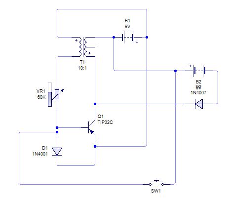

                              Yeah 9 volts batt don't work with Bedini FAN.
                              BEDINI SG PC FAN USING PNP TRANSISTOR TIP32C
                              Bedini FAN works very well with high voltage but low current, is near to be impossible make it work with 9 volts batts.
                              My normal Bedini may work with these batts, but yesterday I was charging them for start the test when one batts get damaged, reads 0 volts. So I think go to buy a new batt alkaline to make the test.
                              Yeah the Bedini FAN is wired the same way but inverting current look the pic
                              PIC CORRECTED COLECTOR-EMITER INVERTED.
                              EXCUSE ME
                              Steve Jobs. Apple CEO
                              • #45
                                Are you sure that schematic is correct? It doesn't look like ANY current can flow through it!
