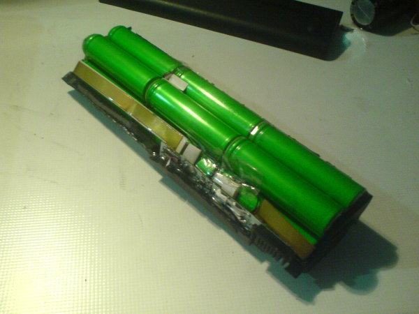

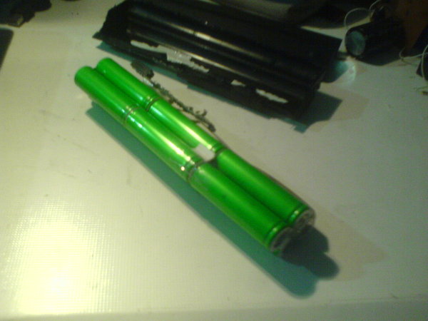

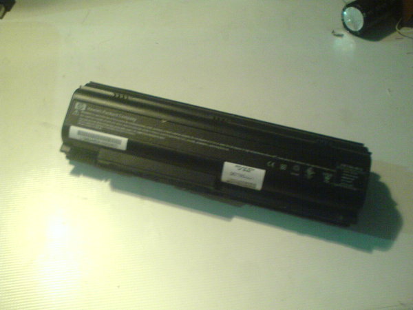

Hi Friends,
I was curious in charging laptop batteries with the Bedini Charger, and I was looking for a way to do this, because as many of you know a laptop battery has some electronic circuitry, which monitor the battery and provide the terminals of the battery upon request. So in order to know how a battery is made, I decided to break a part my old laptop's batteries, and amazingly I found out that it seems quite easy to get the battery terminals out, because they reside at both sides of the battery, which can be accessed by making holes at both ends of the battery. Take a look at the pictures, hope this helps, I am going to make two small holes on my current laptop battery and start charging it to extend the battery life.
Elias
