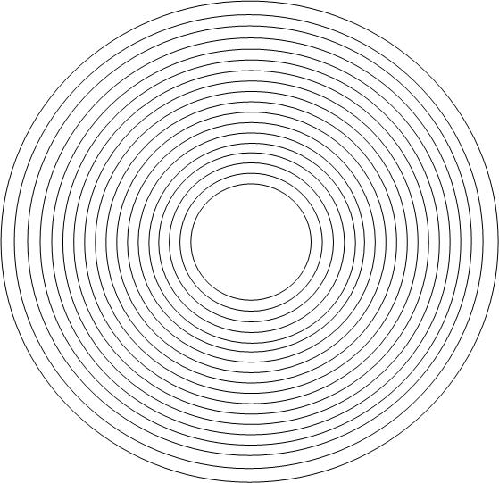

Has anyone thought of trying new designs such as this?
new designs
Do you mean like this?
One of my latest designs uses the attached pic configuration. Currently, testing variations of this design. Good results so far. A good way to cut amp draw and raise measurable voltage at cell is have the innermost tube as -negative, the outermost tube as +positive, and the three tubes in between as neutral, not hooked up to any leads. I have observed production coming from ALL chambers with this design, so the neutrals do become active as well. More to come soon on this design, still playing........................BTW, I used 2 inch pieces of weed-eater cord ( .065 and .080) to separate the tubes. It was the only thing I could get to fit. Used a small wedge to get just enough clearance between tubes to shove in the .080, good snug fit when you remove the wedge. Be careful not to bend the tube edges too much or you may end up with too close a gap and create a short. Good luck, I will post more after some more playing around with it. My tubes diameters are 2", 1.75", 1.5", 1.25", and 1". I suggest to make the 1.5" tube 3/4inch longer and then the 1" tube 3/4inch longer than that, for ease in hooking up leads (at the bottom, of course).
