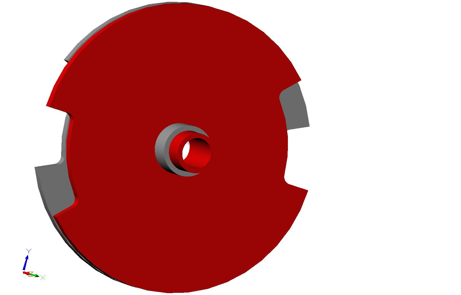

    • Jetijs,
      Here is a little tip that might be useful to you.
      Instead of cutting new shutter disks for your timing,
      Stack one shutter on top of another.
      By rotating one disk in relation to the other, you can easily vary the window opening and thereby change the duration.
      By rotating both disks, you change the timing.

      • Perfect Idea!!!
        Originally posted by hh1341 View Post
        Jetijs,
        By rotating one disk in relation to the other, you can easily vary the window opening and change the timing.
        [ATTACH]732[/ATTACH]
        Carl
        Carl,
        Thanks for finding this little graphic. I was going to suggest this idea to Jetijs, but I am so busy I hadn't gotten around to it. Thank you!!!!!
        Jetijs,
        If you trade out your timing wheel for a system like this, you can find the exact timing window you need....... with a lot of work!
        Peter
        Peter Lindemann, D.Sc.
        • Jetijs,
          You might want to build it this way.
          Will keep your fingers and clothing from getting chewed up.
