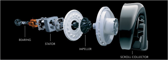

        • Motor
          In fact the Dyson motor is very much like yours:
          See attached picture.

          • Here's a bigger picture:
            The stator/rotor pieces look indeed like my motor. Such a motor would be the perfect for what we need, but unfortunately we do not know how small the air gap is between stator and rotor. If it is too big, than there is no point in buying them for our needs.

              Dyson motor:
              Is that a set of (4) coils behind the Stator (left), on the Dyson motor ?
              I'd also have to say the Tesla Turbine Pump would be a much better match for the Dyson.
              I'll make some phone calls in the morning and try to obtain "Build Quality /Tolerances) for the Dyson. They may even have a catalog of replacement parts

                • Dyson Motor
                  Originally posted by Schpankme View Post
                  Jetijs et al,
                  Excellent recovery on your bolt holes; beautiful work. Would vibration damping (thin rubber washer) allow the bolt heads to distribute the stresses between the Acrylic to metal intersection?
                  Note: an uneven shoulder cut of the bolt heads, may produce stress cracking of the assembly (path of least resistance) during operation.
                  Dyson motor:
                  Best regards,
                  - Schpankme
                  Schpankme,
                  Checking on the tolerances for the Dyson Motor is a great idea. Seeing if it available as a replacement part is an even better idea!
                  One thing about this motor that I am still not certain of is the exact shape of the rotor. The exploded diagram obscures the rotor image so I can't see it completely. The motor Jetijs is building will not START in all positions, but the Dyson Motor probably does, so there must be some differences.
                  Thanks for following up on this and letting us know what you find.
