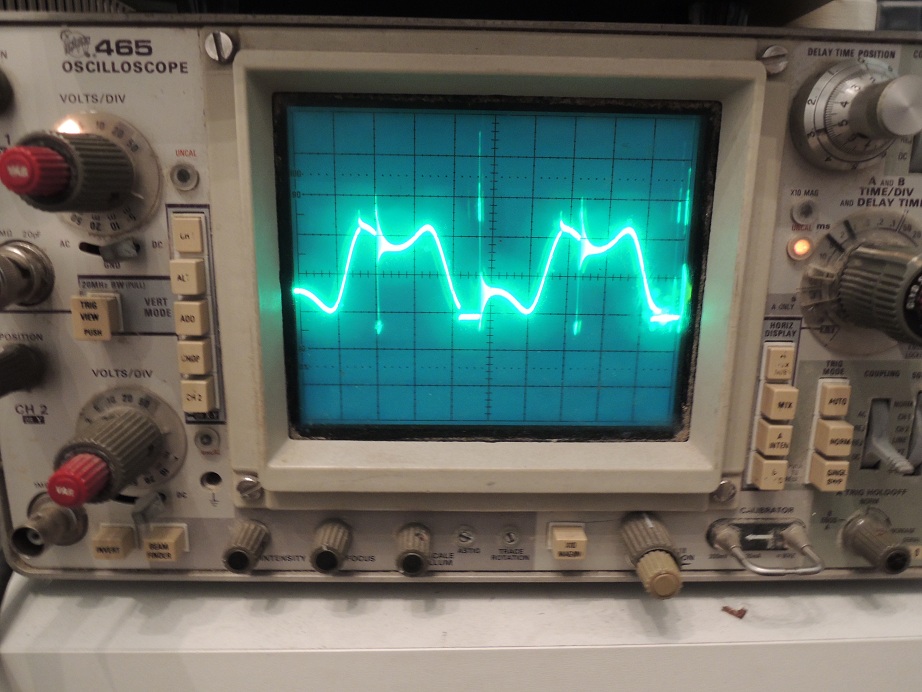

        • Hi Mbrown.
          I decided to ignore the collapsing spikes and am no longer collecting the generator function.
          I ran the motor at 140volts and it went to 3362 rpm with only 0.18 amp
          or 25.2 watts. It does have a lot of torque.(not measured, just felt)
          Look at the position of the driving pulse.
          Here are some scope shots.
          Robert
          • Those scope shots look exactly like what the friend of mine is getting. Im sure he will be interested. I call that the mwm wave, very similar to the kromray converter.

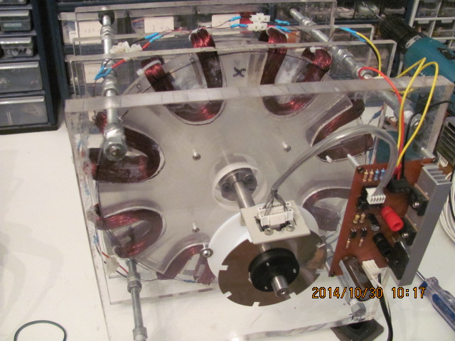

                  • Prototype2...
                    My pleasure Blargus.
                    I just made another one of the same crazy design with a clear view of the design. Really don't know where I'm going with this but it's fun to experiment.
                    The magnets are too small and I'll need to make a new wheel and put
                    stronger magnets.
                    Nevertheless it works great and has quite a bit of torque.
                    If you look at the first scope shot on post 1624, you'll see that the drive pulse is applied at the zero voltage of the generator wave.
                    I can vary the pulse position easily while running which is good for finding the most effective setting.
                    Robert

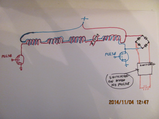

                        • Hi Robert,
                          Thanks for the further details on your interestingly shaped coil setup. I ask how you mean using "the half of the coils" for the test:
                          1) out of each bifilar coils, you used only the single wire coil halves for driving and the other single wire coil halves for generating? (i.e your bifilar coils acted as a 1:1 turns ratio air core transformer, right?)
                          OR
                          2) you used only 4 bifilar coils for driving and the remaining 4 bifilars for generating, using the bifilars in series aiding phase for both?
                          I guess your answer is the first possibility?
                          Now on your question: I think you are correct when assuming you could switch the capacitor to discharge it to a load and the best moment of time and its duration should be found for this switching action, as you suggest during the rise of the voltage on the capacitor. To find it, this definitely needs tinkering and I do not think you are wrong on that.
                          Greetings, Gyula

                            Hi Gyula
                            Here is a drawing of what I mean.
                            Hope this explains it clearly.
                            Robert
                            • Yes, it explains, thanks for the drawing.
                              Now on your switching at the output of the full wave bridge: I had thought that the puffer capacitor would connect directly to the diode bridge output and the switching would take place only between the actual load and the capacitor in the desired and controlled time.
                              PErhaps there is no meaningful difference between the two?
                              Gyula

                                Well I believe there is a big difference because I have noticed that the effect disappears when the cap is not fully discharged but I will nevertheless try both setups to confirm .
                                I'm wondering if this has a similarity with Jim Murray's "reactive power experiment"? since the voltage is lagging or delayed and the current is instantly high. They are out of phase. ( Just a thought )
