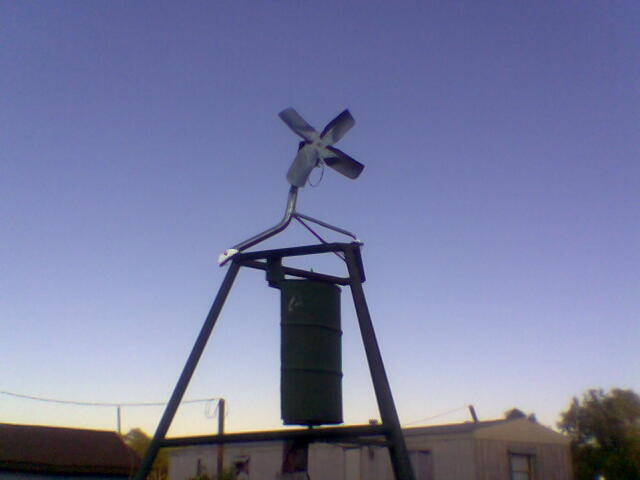

      Here is a shot of the rotor and tower, the tower is 11 feet high, and is 11 feet from leg to leg, in a pyramid shape, which makes it extremely stable and can be moved around the yard without much trouble.
      Also the low height makes any working parts easy to access, while making use of high winds when other mills in the area are putting on the brakes this one just keeps going about 300 or so rpm and sending current.
      This pic was taken back when we just repainted it so the motor and cutoff parts are not visable, I will post a more recent one soon.

            Well, here are the promised more recent pics...

                            New progress..
                            Have a look at the starter I made for the windmill, it has a 90v DC 3000 rpm motor with
                            an industrial fan blade, it is not meant to be a windmill in itself, the purpose is to catch
                            lower winds and help start the savonious rotor.
                            I am pleased to report that it works as planned, it starts the big rotor in as little as 8 - 10 mph
                            breezes, and when there is a really good gust the fact that the blade is not meant for a windmill
                            keeps it from spinning too fast.
