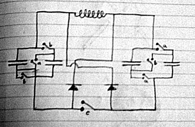

Ran out of transistors so I set up a test rig to see how well it works in principle. I know this isn't the original circuit so I shouldn't expect the same results from it though I am still disappointed with the results so far.
This is the schematic for my test rig... there are 6 switches (if you ignore the bottom one). three are marked "a" and the other three are marked "b".
When "a" is open "b" is closed and vice versa so the capacitor pairs can be switched from series to parallel.
The bottom switch (marked "c") is actually 2 loose wire ends.
First I charge all the capacitors (12.78v - ish) and then very very breifly touch the wire ends together and then measured the voltage of the capacitors. Then I flipped the switches to reverse the circuit and repeated.
I tried it with three different coils (air core, iron filing core, bifilar) though the results were pretty much the same. I have also tried it without the diodes. I just added those as an after thought for the flyback voltage.

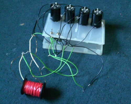

looks a bit of a mess with all the wires but this was just for preliminary tests.
the caps were 4 x 10,000mf rated at 63v each
Without the diodes in the circuit there would be a very pretty blue spark when I touched the wires together which wasn't present with the diodes.
