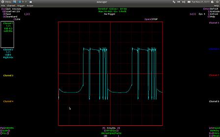

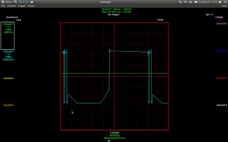

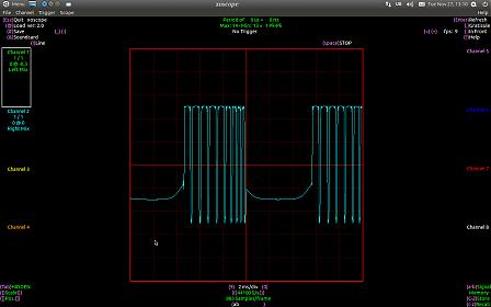

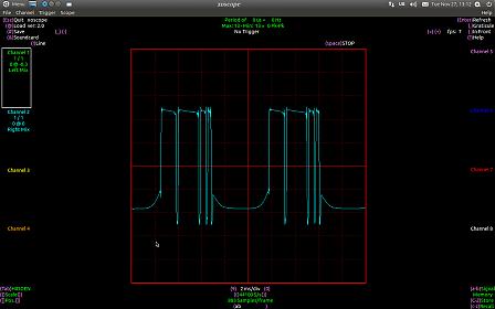

In the first picture I attach you can see a 5'' fan which I have rewired with #32. I had previously tried with #26 and #28 but they would not work no matter what I tried. They just didn't seem to have enough turns. Even with the #32 wire I cannot run it using 5'' fans (shown on the left). Even with 10 Ohms base resistance it just runs for a couple of seconds and then stops. I have to use the smaller 3'' fan. This one I probably haven't tuned correctly and also my batteries are too small for the current (~200mA). The other three fans (shown in the second picture) are within the C20 rating and I'm more confident about their tuning. As for the pots I use (also shown in the first picture) I have trouble believing there's something wrong with them since they seem to work fine, meaning that I can change the fan speed, neon brightness, amp draw by turning them with no problems whatsoever.Last edited by harctan; 12-25-2012, 06:10 PM.

I got a flooded lead acid motorcycle battery 12V 4Ah to experiment with and see if I get better results. I'm currently taking it through charge-discharge cycles as to condition it. Meanwhile I've been playing around with oscillator software using the pc soundcard (and a voltage divider so I don't fry the motherboard). I read in other threads that some guys used an oscilloscope to tune their monopole motors with this simple method: increase base resistance until you go from one pulse per magnet pass to two pulses per magnet pass, then go down again to one pulse and that's it. I'd be interested to know if that is a valid method of tuning and if that would also apply to the modified fans. I attached the probes of my homemade oscilloscope between the collector and emitter of the transistor to see how it pulsed. The pictures I attach show the results starting with high base resistance and then lowering it. You can see that as I lower the resistance I get less pulses until I get only two with the one lasting much longer than the other (at 56 Ohms). But the sweet spot, using the neon to evaluate it (after I unhook the charging battery), is much closer to the first pictures where there seem to be more pulses. In fact in the last picture (at 56 Ohms) the neon doesn't light and the charging is very poor, if any. I'd like to know if these results are accurate and what do they mean exactly. Also is there some other way to use this basic oscilloscope in this project?

Using a scope you want the highest voltage spikes, the number of spikes is not important with the fan. The single spike, double spike etc is more relevant to the bicycle wheel SSG. Your first picture looks more like what you should be getting.
Try measuring the charging battery with your scope, you should see small spikes and this is a lower risk of killing your computer. Tune so you have the highest voltage on the battery. you will see that these small spikes start at about 2v above battery voltage and then drop down to a few milli volts as the battery charges.
