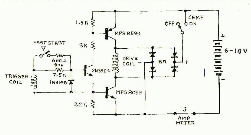

Hi folks, hi blackchisel97, not sure if you've noticed this as I have with J.B. solid state circuit. I'm charge/conditioning a 6 cell nicad 1700mah pack and drawing 400 milliamps input using 13.8vdc supply and when I try the 1 ohm test the input drops to 140 milliamps and volts across 1 ohm show .6 volts and i notice the frequency decrease when making the 1 ohm test and when charging the battery the frequency is at least double if not triple. Does anyone know if when put back on charge battery, is it still seeing the same overall output watts with maybe a reduced voltage due to lower impedance, so as to be in the safe region as per the 1 ohm test. This confuses me since I thought with the blocking flyback diode it was supposed to be independent from input, transistor off collapsing field. It's charging well though and bringing the battery back to life. Any thoughts appreciated.
