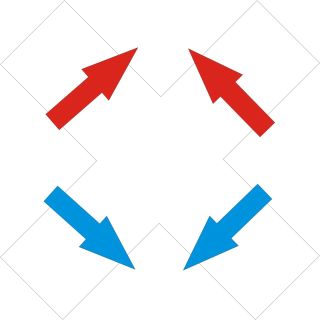

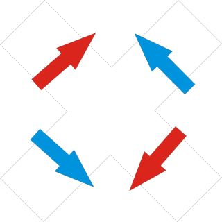

The PC fan: I found a few fan, and all were wound alternately: clockwise and counterclockwise direction, each anchor opposite direction. I have damaged the original winding, so I have to make new ones. The first attempt - everything winding clockwise (fan1.jpg) - does not work. Winding has 7 Ohm, wire 0.3 mm, 200 turns on the anchor.
Picture: fan2.jpg - does not work.

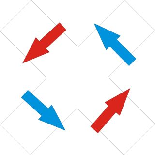

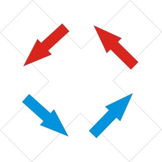

Even try new winding, weaker wire with greater resistance and alternately clockwise and counterclockwise direction (as fan3.jpg), maybe this will help.

every fan i have wound has been cw bifiler (two wires together),then ccw bifiler, then cw bifiler, then ccw bifiler (cw =clockwise ccw=counter clockwise) all have worked ,have used large wire 40 winds per pole and small wire.60-80 winds per core, the larger wire required more source voltage 24-36 volts dc hope this helps but remember computer repair shops will some times give you old bad power suppies with fans in them, you can get these fans every where but if you want to rewind cw,ccw cw,ccw, -two wires at the same time will work in most cases. enjoy good luck and dont give upOriginally posted by tbest View PostHi ** ~ ~ Imhotep **.

No, I dont have any link, my original fan was winding under the third picture from left, but damaged. I tried the second and third type of winding. Perhaps it is to be the last type?Originally posted by Sephiroth View Posthmmm.... i was worried about that... any links to where I can roughly see the coil configuration?

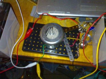

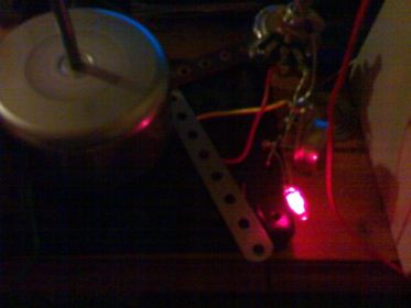

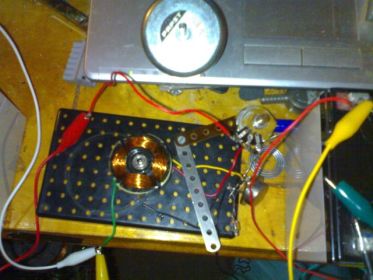

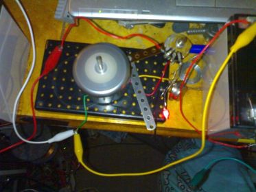

Wound 200 winds per cole 0.3Cu cw-ccw-cw-ccw.Originally posted by **~Imhotep~** View Postyou are very welcome, please share all new knowledge with everyone ,it feels so good taking charge of your your own power needs destiny .yea!!!!
Run battery 12.30V
Charge battery 10.01V
After 30 minutes:
Run battery 12.27V
Charge battery 10.73V
A few pictures.
________
Ford Cologne V6 engine historyLast edited by tbest; 02-07-2011, 09:52 AM.
Re: up and running.
Can you tell me how many amp hours is your battery? I am curious what size of battery you have. Congrates on getting this going.Originally posted by tbest View PostWound 200 winds per cole 0.3Cu cw-ccw-cw-ccw.
