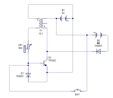

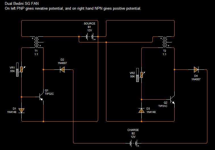

You have discovered the self oscillating effect that can happen if the resistance is too high on the base. You should be able to trigger it simply by hooking it up and switching it on. I have a self oscillating trifilar with a full cap pulser on the back end that works really well. There is actually a better way to configure this, just using resistance, no diode needed (except for output). Check the radiant oscillator thread for Jets post. And you dont have to have a specific resistance on your coils for it to work, usually anything with over 300 turns you can get to do this.
Have fun, if you want to build this thing from scratch then just wind a bifilar coil 450 turns and wire it up exactly as you have for the fan. Use an air core (i.e NO core) and your frequency will be alot faster.
kinda funny, but this is what works for me.
