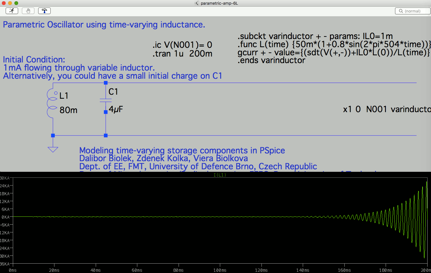

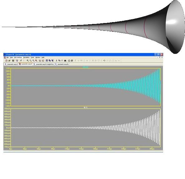

              Chris Carson's device is a Parametric Amplifier. Please see the attached file, parametric.txt for information on how it works.
              I wrote 4 LTspice simulations of time-varying reactance oscillators, you can play with and see how it works.
              parametric.txt

              • #22
                The only times I ever succeeded in simulating overunity cleanly, without sporadic spikes (in LTspice and MicroCap), but with clean arching wedges, in Eric Dollard's analog computer in LMD mode, is when its central capacitors possessed negative parallel resistance in addition to possessing positive series resistance. But I kept wondering what this means and how is it built?
                The answer lies right here in this thread! Parametric capacitance!!! What gave me a partial clue is when someone on Quora explained to me in describing this phenomenon as being that of an amplifier...

                        One solid state device which can vary capacitance with respect to time is a Varactor Diode. Also called a Varicap. This is what is used in real Parametric Amplifiers.
                        Another way to do it is to vary inductance with respect to time. This can be done by moving the core in and out of a coil, or by saturating and un-saturating the core, as is done in a magnetic amplifier.
