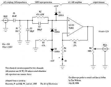

            well i decided to make me Buffer Hardware for xoscope
            and im on the hunt for capacitors and i need a 20 picofarad capacitor and the capacitor code is 200 i noticed some capacitor only have 2 numers on them ie 20 with a underline and was wondering why some only have 2 numbers is the one marked 20 the same as the code 200?

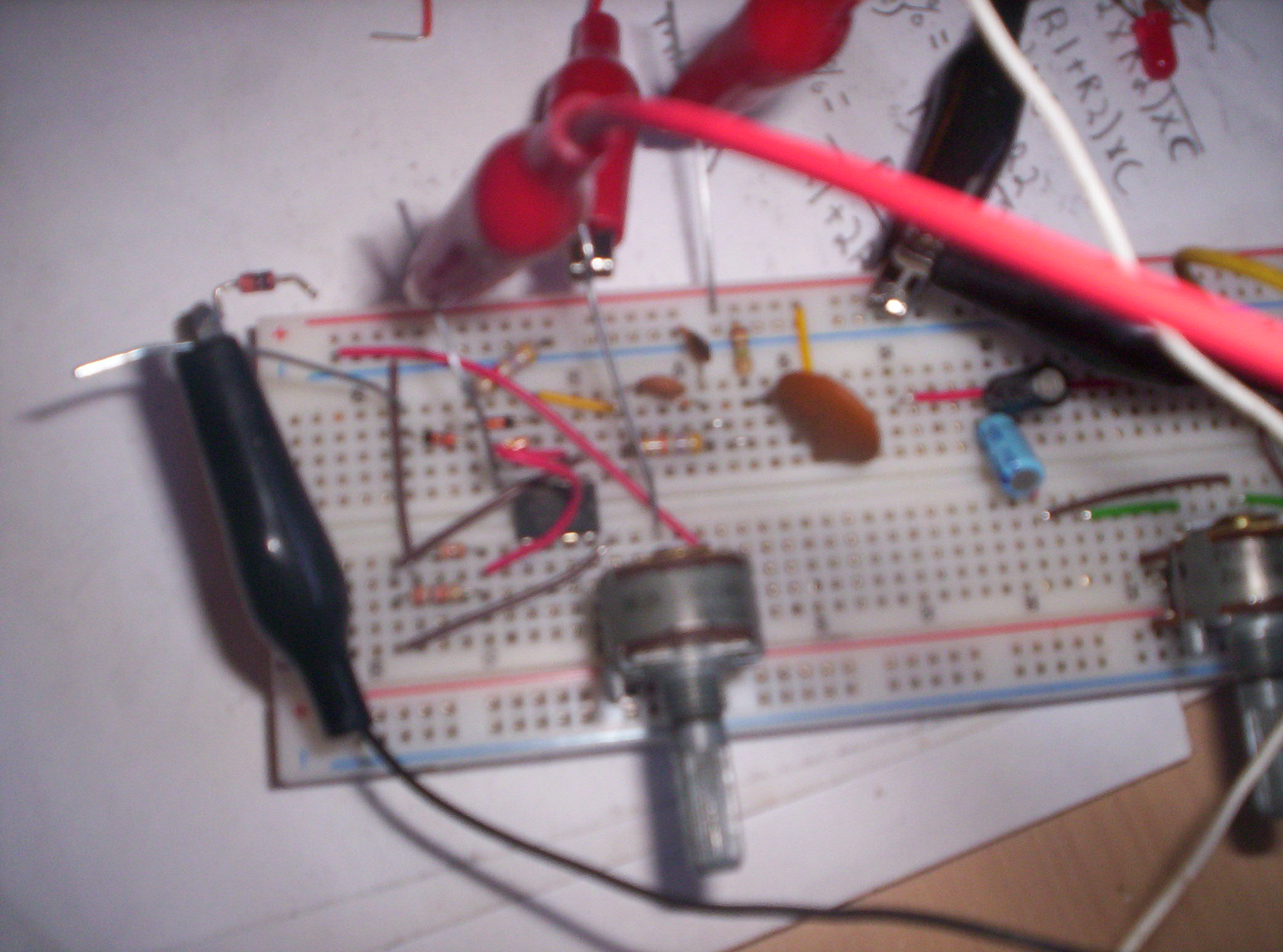

              well heres my ugly prototype
              and the schematic for the sound card scope found all the parts in a old tv converter box from the recycling center near me
