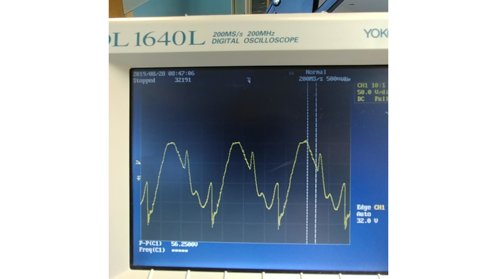

The driver produces the above fast uni-directional pulse which results in the primary seeing a 100v change in just 10ns. With a 50v DC supply to the driver I am seeing 200V peak-peak sort-of-sinewave on the primary, which is purely reactive at 8 ohms. (voltage and current 90deg out of phase)
The attached photos show the waveform across the primary (2 turns), note the negative fast transient ..

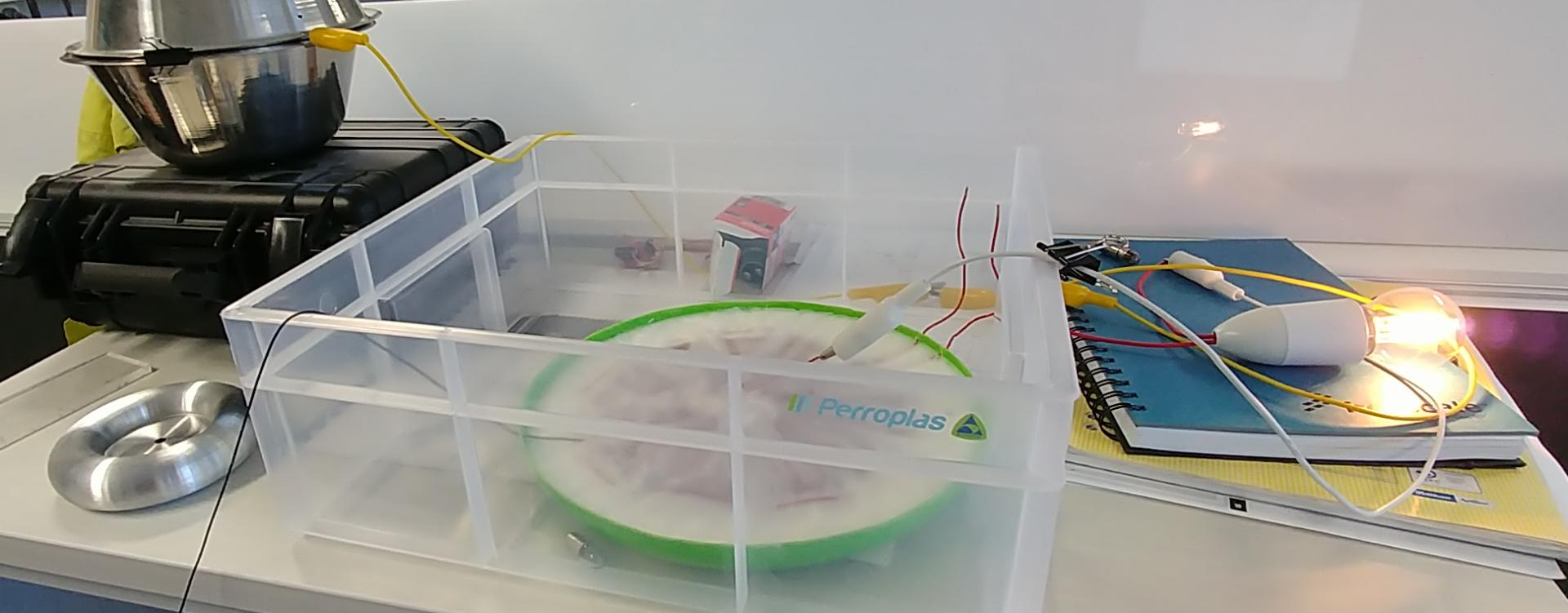

I have also attached a photo of the receive setup
