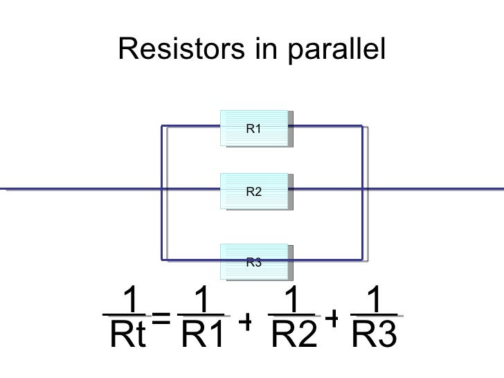

          It may be the correct value but your equation is wrong.
          1/Rt = 1/R1 + 1/R2 + 1/R3 + ..... 1/Rn.
          Originally posted by NROC View Post
          The value is right,
          The equation should just be 1/(1/R1 + 1/R2 + 1/R3)
          All the Best
          I really got these guys rattled the math you have down pat.
