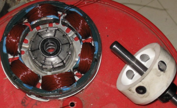

                  ..I've been building these machines for a few decades now. I have a
                  large unit that will rip a 60 lb flywheel right out of your hands and uses custom made N52 neos. I used to sell a 3 phase radial air core
                  alternator kit that would produce 500 watts and fit in the palm of
                  your hand.
                  Anyway, neither here nor there...
                  An example shown in the generator below of one I built a few years back
                  to remove or lower the Lenz effect.
                  Although a different design it's very similar to what Turion is doing. ( and, no, it is not overunity just very efficient )
                  With the cores side by side the start up and running torque is minimal.
                  Simply suggestions based on what I've found "on the bench".

                    • Hi Dragon.
                      You make some interesting points.
                      I hope you don't mind me asking but that looks like a nice piece of hardware to work with. Only if you can spare the time.
                      The hardware with the windings, i'm assuming it's the stator. What is it off. or is it custom built? How are the individual cores attached to the rim piece, or how do you get them off for winding? And how are the magnets attached to the rotor. I'm probably being a nusence, and some tricks of the trade are hard earnt, but if your feeling generous that would be cool to. Not too much detail required. I will get the gist.
                      regards
                      Edit... Good luck SkyWatcher, I'm hoping you can get good juice out of that coil.
                      • Originally posted by lotec View Post
                        Hi Dragon.
                        regards
                        This is Sky's thread so I'll keep it brief... This project was a quick and simple conversion to prove a point. The core is from a standard box fan with all the wires cut off and rewound for the testing I wanted to do. The center is a machined steel core ( machined for the bearings and mounting) mounted to the backing plate. The rotor was machined from plastic with the iron pole pieces glued in place. The pole pieces direct the flux through the core as it rotated. Even though it worked very well and it was very efficient I didn't consider the added efficiency difference over a standard alternator to be great enough to pursue. I later built a large conversion using a donor 3kw gen head which worked ok but again the efficiency gain wasn't much over the standard off the shelf units so I moved on to other ideas and thoughts of how to increase the efficiency in other ways.

                              Hi all, made a few tests today.
                              Each power channel gives around 75 volts ac, coil open circuit.
                              Each 13 strand channel is around 31 ohms.
                              Tested standard 120vac, 6 watt led bulb on one power channel and it lighted to a decent brightness and the watts did increase from the 145 watt no load input.
                              Tested a 10 ohm resistor load on one channel and watts did not increase, maybe slightly dropping.
                              Though measured volts over the 10 ohm resistor showed only .89 volts ac.
