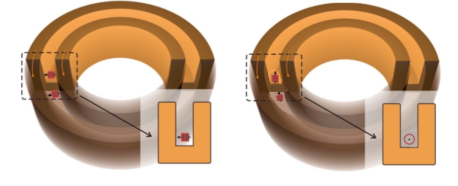

I think I see what they're doing.
Where from?
Thanks Arne,Originally posted by seaad View PostIt seems that we have two situations here about the directions of the coils.
Arne
What is your source for this graphic?
{edit}
This reminds me somewhat of the Faraday paradox.

1 My own snippet from your sources/ pics above. Pls correct me if I'm wrong.Originally posted by bistander View Post1) What is your source for this graphic?
2) This reminds me somewhat of the Faraday paradox.
And W. Paint.
2 Yes agree, but not exact. A moving rotating conductor and at the same time a short "coil"?, rim to the origo axel.
But again no flux linking. Only one coil! AND DC!
Idea: And DC! Why not AC? Lets chop, chop the DC and make AC. Now we can link the flux to another coil.
Regards ArneLast edited by seaad; 11-25-2018, 07:04 PM.
